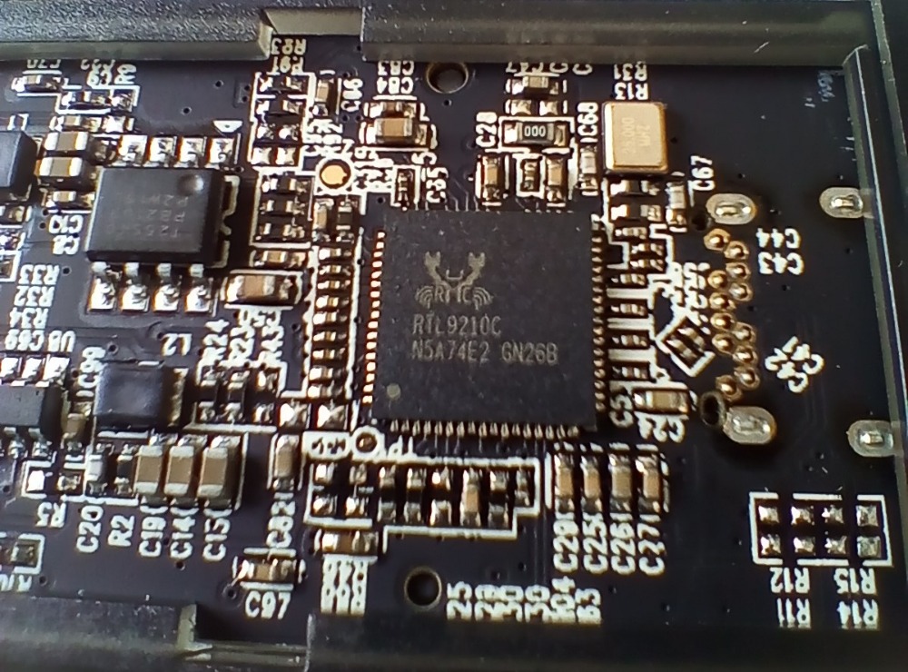

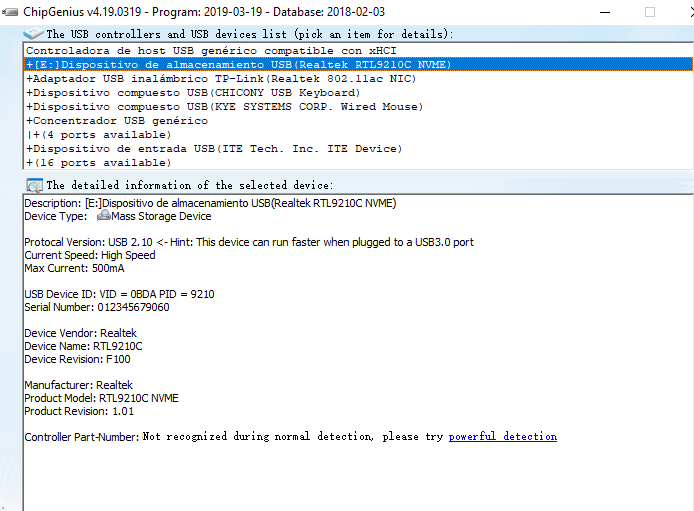

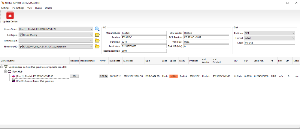

Hi everyone, I would like to know if anyone has had the experience or encountered the RTL9210C driver. I have read the entire post from top to bottom and I can't find any reference to it. I have also downloaded all the available firmwares without being able to find the missing .bin. I have also had no luck searching the web. Maybe it is a re-written or fake chip?
I have started this search because I can't get it to connect at a speed other than USB2.1. I have already changed all the cables (I even bought a Lenovo cable certified as 10mbps) and I have tried on several computers without success.
I would appreciate any information in advance. Thanks
