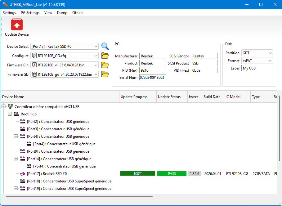

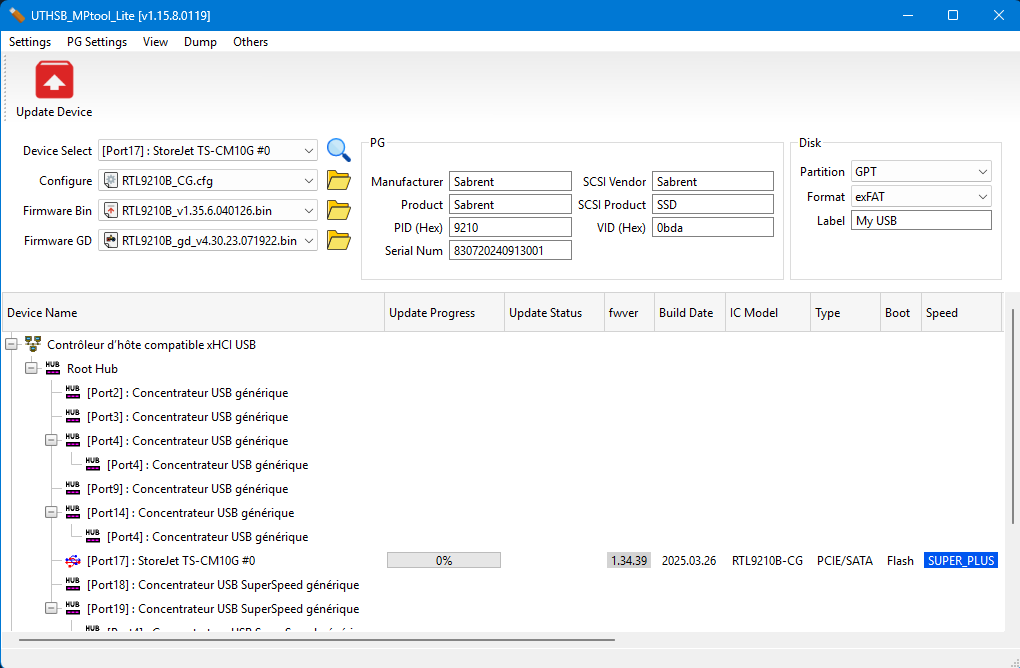

5 days 36 minutes ago - 4 days 22 hours ago
New Firmware Realtek RTL9210(
NVMe/USB 3.1 Controller firmware Version 1.35.6.040126
www.station-drivers.com/index.php/en/com...6.040126/lang,en-gb/
NVMe/USB 3.1 Controller firmware Version 1.35.6.040126www.station-drivers.com/index.php/en/com...6.040126/lang,en-gb/
