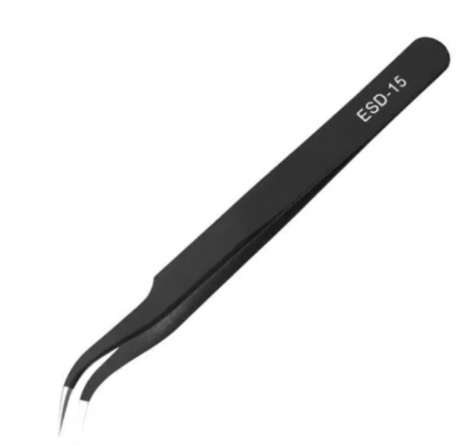

It happens that the firmware doesn't go well, but luckily there is this solution. As Shonk said, be careful not to touch other contacts; I do it with fine-tipped tweezers.
