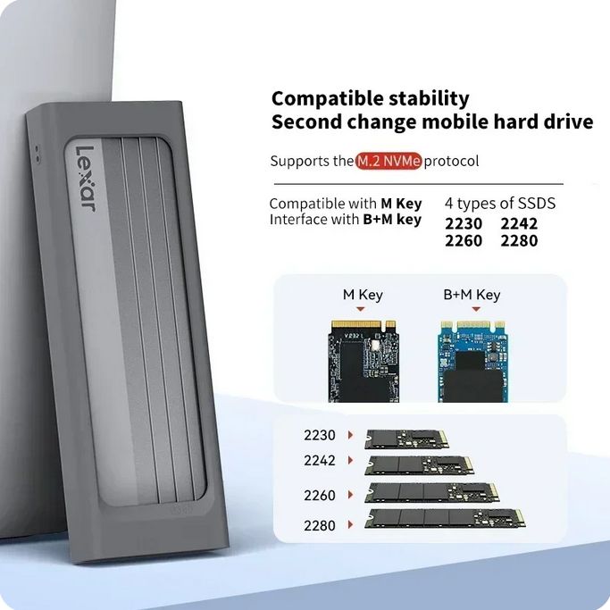

I have bought a
Lexar E300
NVME enclosure.
Here is the Dump:
In comparison to most other Dumps, there are much values marked as "n/a".
For example:
U2PHY = 02 f4 9b e0 e1
U3PHY = 02 d4 09 00 d5 00 80
DISK_HOTPLUG = 0x0
PINMUX1 = 0x0
PINMUX2 = 0x700
U2_MAXPWR = 0xfa
U3_MAXPWR = 0x0
ASPMDIS = 0x0
For what are these values for?
Is it recommended to add it at the config file?

- Posts: 42
2 years 2 months ago
are you sure that´s a Realtek RTL9210/RTL9220 Chip inside?
