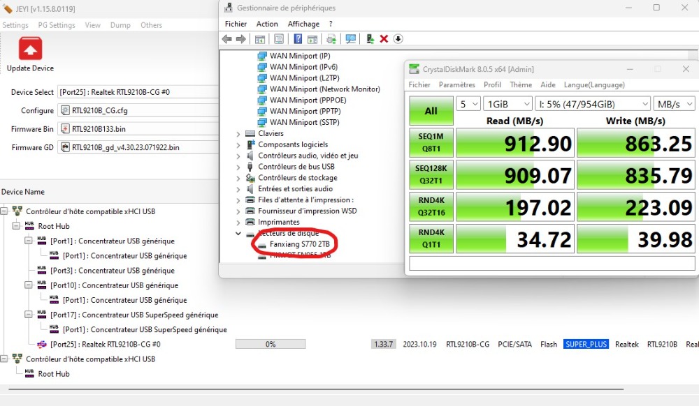

Hi,
link fixed
Realtek RTL92xx(
NVMe/USB 3.1 Controller firmware Version 1.33.7.191023 (station-drivers.com)
link fixed
Realtek RTL92xx(

Thank you for the new firmware!
What exactly is the GD firmware for? This is still included in the packages for the 9201, even though the firmware bin for the chipset has not been updated for some time.
I'm just wondering whether it makes sense or is perhaps even harmful to flash them individually.
I've done a lot of searching on the net, but unfortunately I haven't found out exactly what the GDFW is for.
Could someone also tell me what the latest firmware for the 9201R is? Thank you!

The latest firmware for the RTL9210 is v1.33.7

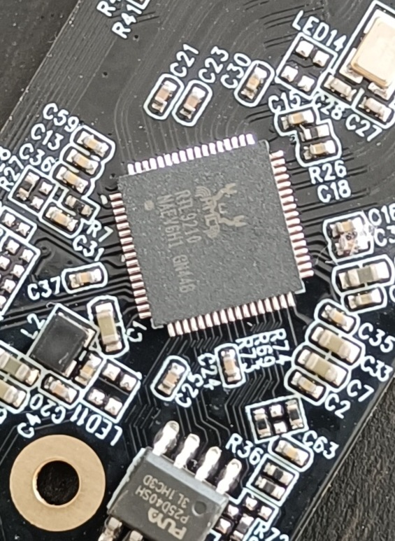

I bought a cheap noname USB enclosure from Aliexpress with RTL9210. They marketed it as dual-protocol, compatible with both NVMe and SATA drives. I want to use it with M.2 SATA drive from old laptop (Hynix SC311), but the drive isn't detected there at all. I tried to put a NVMe drive into the enclosure and it worked, but I want to use it with the SATA drive. Is there any way how to get it working, or RTL9210 works only for NVMe drives?
BTW, original firmware was 1.32.7, tried updating it to 1.33.7, but no change.
