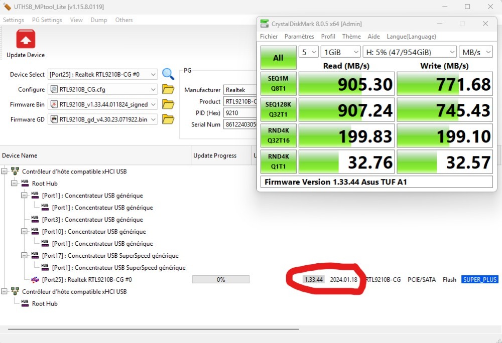

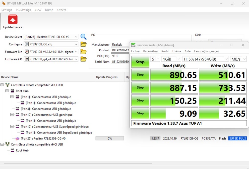

New Firmware Realtek RTL92xx(
NVMe/USB 3.1 Controller Version 1.33.44.011824
A big improvement to my Asus TUF A1 (RTL9210B) in terms of speed
NVMe/USB 3.1 Controller Version 1.33.44.011824A big improvement to my Asus TUF A1 (RTL9210B) in terms of speed
