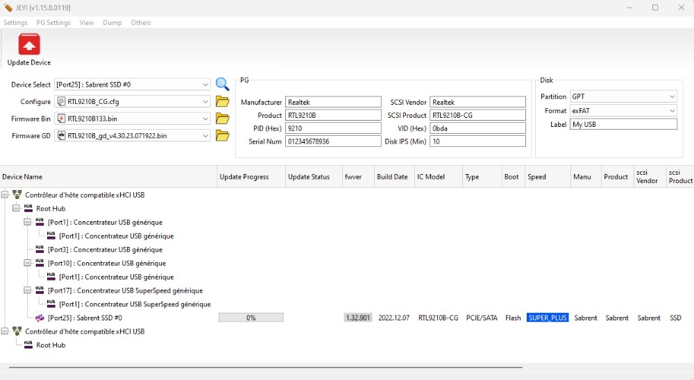

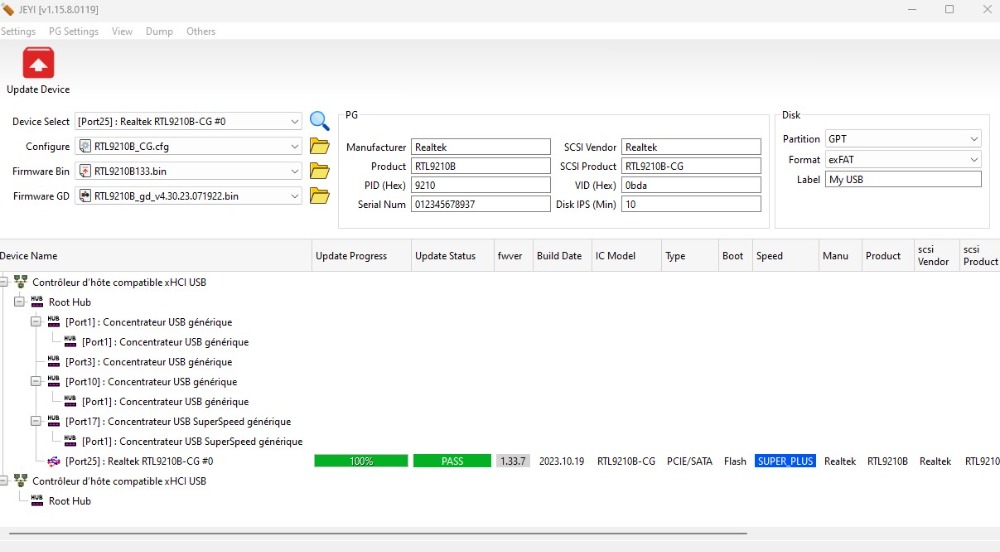

2 years 2 months ago - 2 years 2 months ago-
Realtek RTL92xx(
NVMe/USB 3.1 Controller firmware Version 1.33.7.191023Donwload
