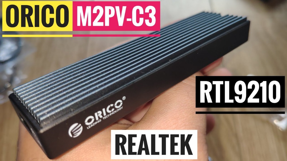

For anyone who wants to download and try the latest firmware v1.32.82 for the RTL9220 controller and wants to use it with the enclosure in the picture please keep in mind the are 2 different configure files,you need configure file RTL9220_ARGB.cfg
I got the firmware from the official JEYI store and uploaded it to admin and they told me they also changed the configure file for the enclosure as well and if you check your dump file it may look nothing like RTL9220_ARGB.cfg which is the one you are supposed to use.
I can confirm that I have tested v1.32.82 of the firmware and both configure files and they both seem to work fine with the enclosure and the RTL9220_ARGB_UART.cfg configure file is supposed to be for a yet to be released enclosure from what they told me.

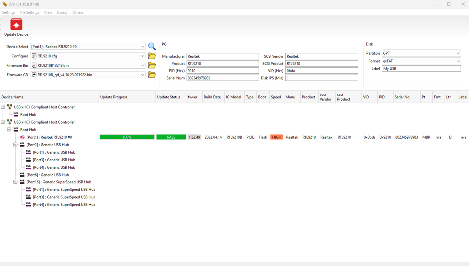

Tried flashing with 1.33.44, 1.33.7 1.32.68 but failed with no config file issue.
eventually worked with 1.32.49
Orico shipped with 1.23.15 2020.11.16, unit was bought just last week.

@Wolfspam I own the same enclosure and I got it to flash with v1.33.44 and use configure file RTL9210_VB_CG_Orico_0_Mod.cfg I don't know why but I have had it had more then a few times like 5 or 6 times when updating the RTL9210 that it often fail then you try again with the same firmware that you just tried to flash the enclosure with and then it successfully flash's.
If you don't have this configure file I can email it to you.
