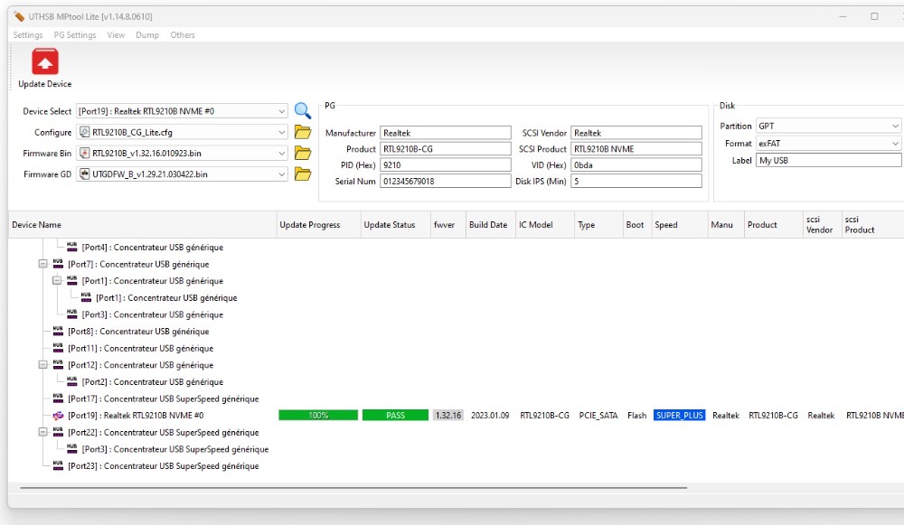

I tried downloading v1.32.16.010923 and tried putting the RTL9210B_v1.32.16.010923.bin and UTNVME_B_v1.29.391.072822.bin that uploaded into UTHSB_MPtool_Lite_1.14.8.0610 installer along with configure file RTL9210_Lite_10.cfg but for some reason it won't even try flash my device.
Is there something I'm doing wrong.
Thank you machi007
on my side no problem everything works fine
www.station-drivers.com/index.php/en-us/...6.010923/lang,en-us/
