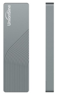

here is mine from Unionsime copy of the hikvision
www.station-drivers.com/index.php/en-us/...-hikvision-enclosure
Device : [Port19] : Unionsine MD202 #0
U2PHY : 02 f4 9b e0 e1
U3PHY : 02 d4 09 00 d5 00 80
PID : 0x9210
MANUFACTURE : "Unionsine"
PRODUCT : "MD202"
SERIAL : "012345679545"
SCSI_PRODUCT : "Unionsine MD202 "
SCSI_VENDOR : " "
DISK_HOTPLUG : 0x00
LED : 0x02
PINMUX1 : 0x00000000
PINMUX2 : 0x00000700
U2_MAXPWR : 0xfa
U3_MAXPWR : 0x00
ASPMDIS : 0x00
DISK_IPS_THRES : 0x0a
CUSTOMIZED_LED : n/a
FP_UART_BAUD_RATE : n/a
EFUSE :
Boot Mode : Flash NM
FW Ver : 1.29.12
FW Build Date : 2022.01.11
IC Ver : 0xa0010002
IC Pkg Type : PCIE_SATA
Disconn_ForceUSB2 : 0x00
