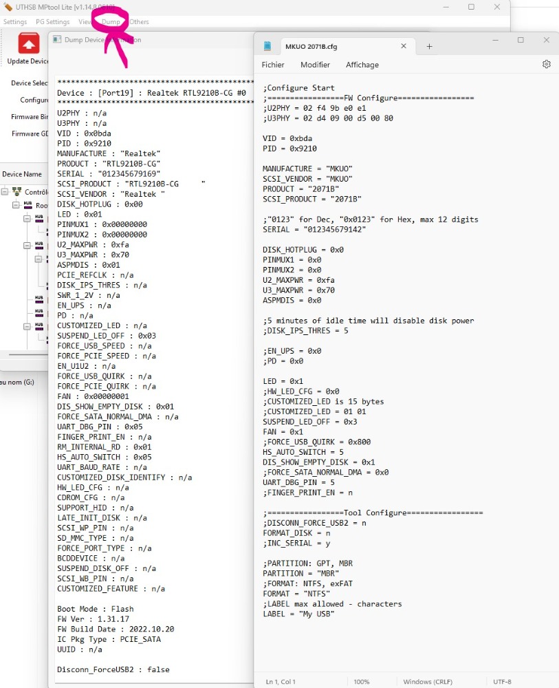

You can easily publish the image I did for mine case containing the latest firmare 1.31
Disque Dur Externe,boitier Disque Dur,disque Dur,ssd Externe,boitier Ssd,disque Dur Externe Ssd,boîtier Double Protocole M.2 Nvme Ssd 10gbps Usb3.1 Gen2 Nvme, Boîtier M2 Sata Ngff 5gbps Ssd Pour Ssd 2230/2242/2260/2280 - Boîtier De Disque Dur - AliExpress
I'm not 100% certain of what your asking me,do you want me to post picture's of my enclosure from aliexpress.
Also can I somehow when I get my next shipment of these enclosure's can I take the setting's and transfer them into the newest firmware somehow.
Yes I saw that you posted pictures of your box, it was just to tell you that if you have pictures to put here don't hesitate
Otherwise for your file, I do not know if the backup file is not written like the original file (cfg), it must be modified I believe

I figured out what configure file to use for this enclosure,I used the RTL9210B_CG_Lite_10.cfg file from the 1.30.21.070622 firmware from this site.
The Led light now blinks the way it should and work fine.

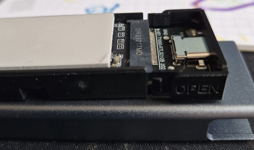

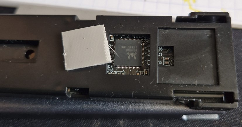

I also forgot to mention one other minor issue with this enclosure and that is the silicone pad is not thick enough to touch the aluminum case and from what I have read and seen in reviews that you better to leave it off if that is the case because the silicone needs to touch the metal or else it will actually make the ssd run hotter.
Thankfully I had some 1.5mm and 2mm silicone material that I purchased from aliexpress and it was extremely cheap,the 2mm was thick enough that the lid would still slide on and still touch the lid at the same time.

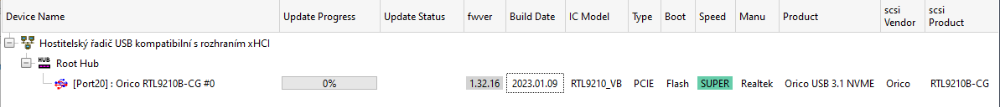

New firmware version:
RTL9210B_v1.32.16.010923
Build date: 2023.01.09
Found here:
github.com/damnnfo/rtl9210b-firmware
Tested on my Orico TCM2-C3 and works fine!
