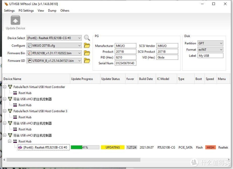

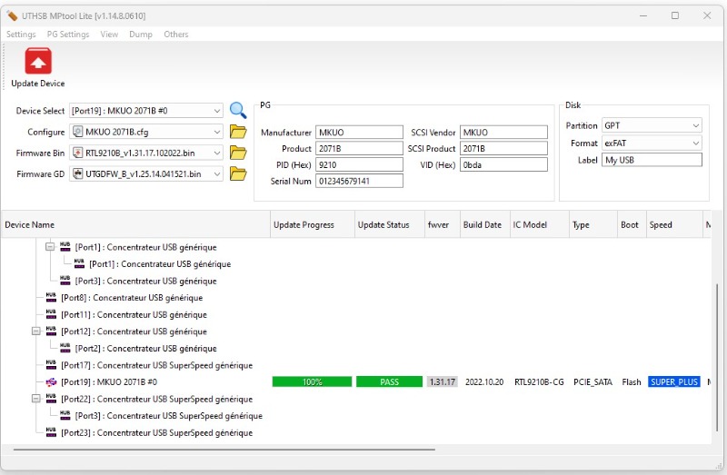

I bought an RTL9210B solid-state hard drive box on the Pinduoduo shopping platform. The brand is MUKO and the model is M223CC. I got a copy of the RTL9210B V1.31.17 firmware from the customer service and updated it successfully. I plan to share it. 我在拼多多购物平台买了一个RTL9210B固态硬盘盒。品牌为MUKO,型号为M223CC。我从客服那里拿到了RTL9210B V1. 31. 17固件的副本,并成功更新。我打算分享它。

(Please note! Because I only have this RTL9210B hard disk enclosure, I cannot test whether other brands of hard disk enclosures can be flashed into the firmware. It may be risky, please judge by yourself) (请注意!因为我只有这个RTL 9210 B硬盘外壳,所以我无法测试其他品牌的硬盘外壳是否可以闪入固件。可能有风险,请自行判断)

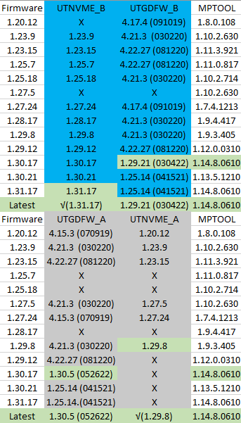

@xz Thank you maybe you can ask Support why an old GD firmware was used

thanks for your UTGDFW_B_v1.29.21.030422 info.
I did the update with UTGDFW_B 4.22.27 i did not realize that UTGDFW_B_v1.29.21.030422 is the last one
I re-updated the firmware with correct one.
