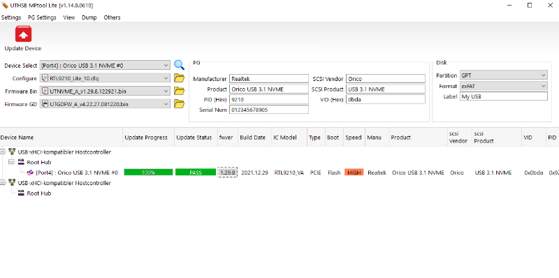

- Posts: 45
If you brick RTL9210 Driver her is a method to unbrick Drive with Reset SERIAL FLASH MEMORY Chip with 8 Pin same Procedure for JMS583.
Find a Chip on the board that is small and has 2x3 mm aspect ratio and on the top is printed P25Q40SH or FM25Q04A or PUYA P25D40H. Search for the Datasheet of it look for CS# and VCC Pin or CS# and Hardware Reset Pin in Datasheet description of Pin Configurations. There is a Hard Reset Procedure on Rom in case of bricking your device. You need to short pins 1 & 8 with tweezers then connect to USB port for 10 seconds (until you hear a ding) and then remove the tweezers (unshort) while it still plugged in and flash a working Rom via USB from here. This will force RTL9210 to start with internal ROM, not with external f/w in SPI flash.
ibb.co/PQmpVnz
try to Upload my Image her but its still imposibel maybe Admin can do this?
You can download older Firmware from Orico search for M2 NVMe协议硬盘盒休眠修改 for download click on that 下载
ibb.co/PQmpVnz

What is the difference between UTNVME and UTGDFW? I see GD being referred to as "Firmware Golden" but I don't know what that means.
