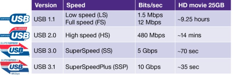

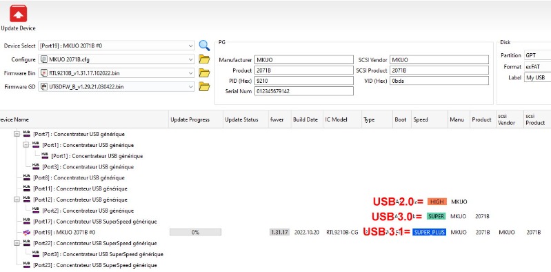

I allow myself to add that certain USB-C cable provided does not sound efficient to be able to have 10Gbs so try with another USB 3.2 cable (10Gbs) and also check that you are on a USB 3.2 port
