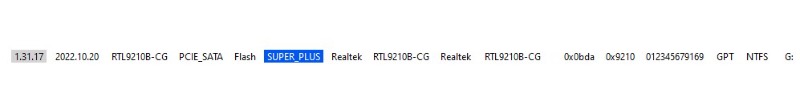

Have tried downloading the newest firmware from this link and run the tool called UTHSB_MPtool_Lite and not the one with mini on the end of it's name.
Next look at the top section of the installer it should say IC Model somewhere I mine said it was a RTL9210_VB.

(Have tried downloading the newest firmware from this link and run the tool called UTHSB_MPtool_Lite and not the one with mini on the end of it's name.

As far I know it's not possible with the Realtek's firmware update tool.
- Posts: 45
Yes it´s not possible but you can Dump the Original Configs and save it and share it ?
