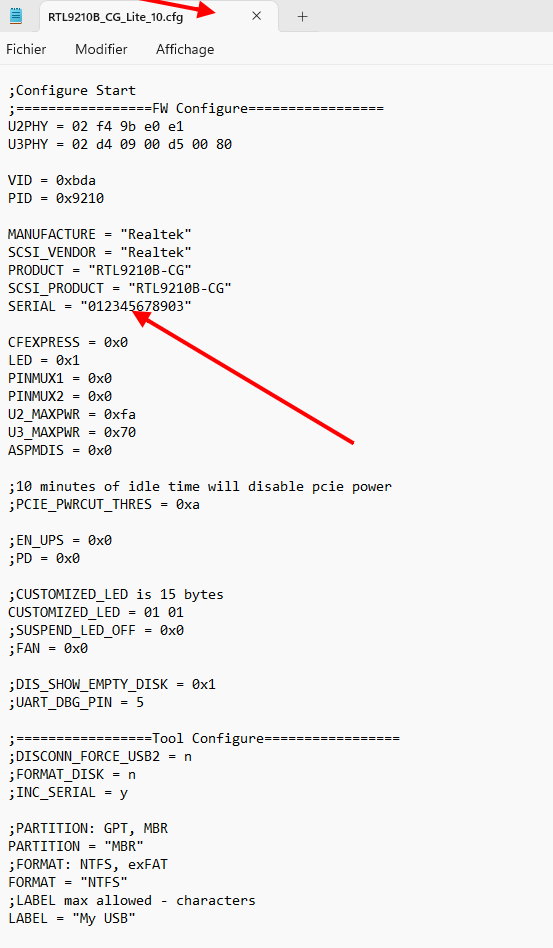

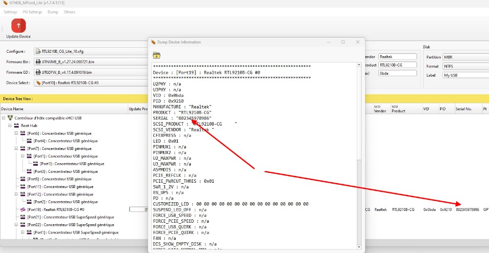

Anyone have any idea how to make it show an actual serial number of installed SSD or atleast change it to something else instead of "0000000000000000" that is showing up in cmd when doing wmic diskdrive get SerialNumber command?

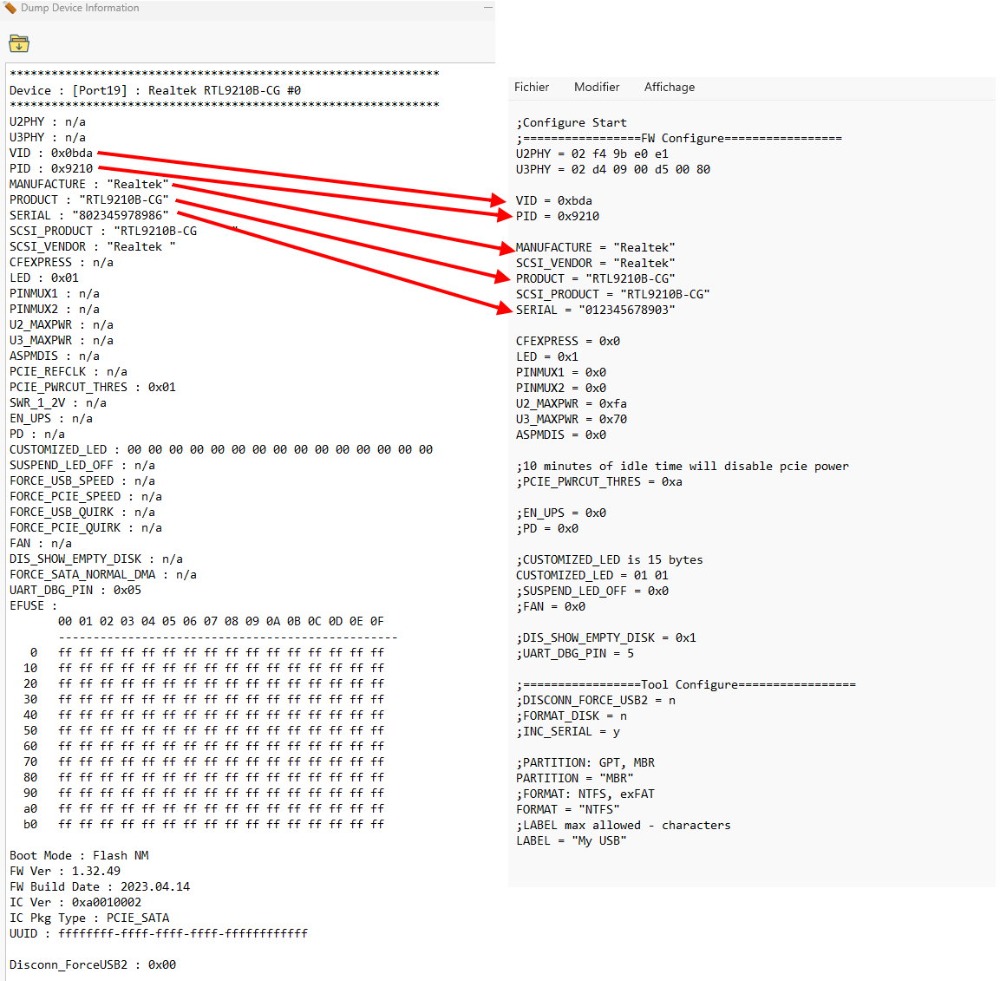

Hi, you open the dump to retrieve the configuration of your box then you compare with a *.CFG file like the one below then you copy between the Dump and your source *.CFG to match and at the same time you change your serial number then you save your *.CFG in backup.cfg for example.
in the Tool, just take the backup.cfg file instead of RTL9210B_CG_Lite_10.cfg then select the firmware to update it

Thanks for reply, editing serial in config is what I tried first - seems like it does nothing, serial changes if I look at the new dump after flashing but system still shows zero's instead of serial
