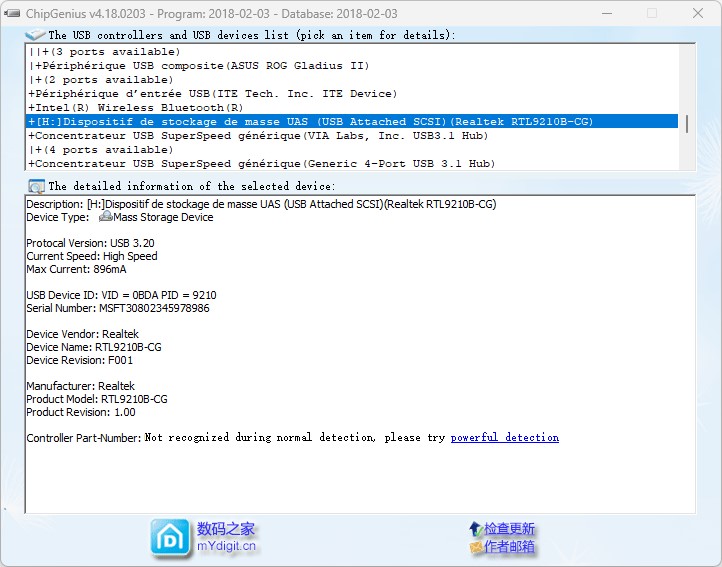

to be sure to be in USB 3.2, check with the Chipgenius utility below

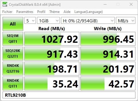

the 500 Mbps instead of 1000Mbps and a speed problem due to the port or the cable as said by Alien Invader
The firmware can also but already check the port then the cable (USB-C port)

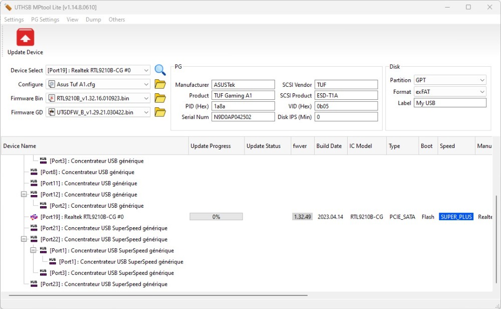

or via the update utility (Super plus)
