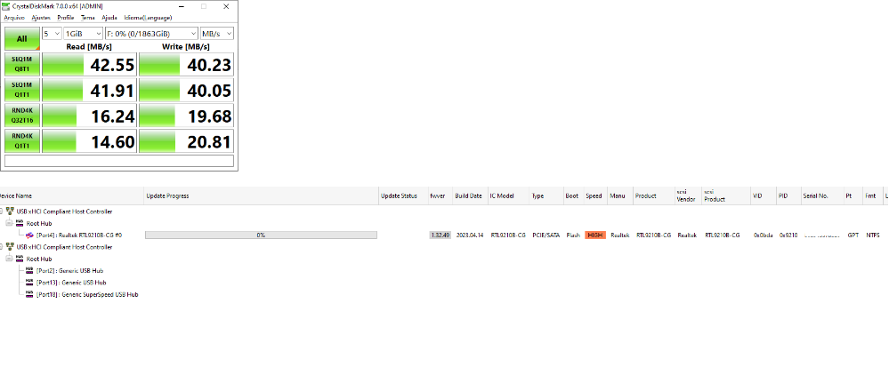

hello, i have an orico M2PJM-C3 with a RTL9210B with a Western Digital Green SN350. i have updated the firmware to 1.32.49 and i have this crystaldiskmark results. what am i doing wrong?
I also tried to run ubuntu and keep getting the drive to shutdown apparently. dont know what is happening.

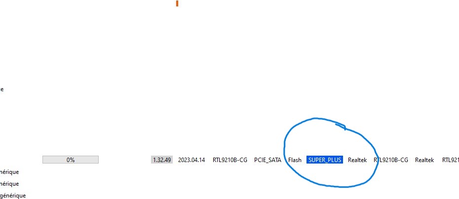

spike_V_sky you are absolutely right, check that you have connected to a USB 3.2 port
USB port speed
USB 2.x
USB 3.0/3.1
USB 3.2
USB port speed
USB 2.x
USB 3.0/3.1
USB 3.2
