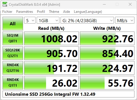

3 years 4 months ago - 3 years 4 months ago
by putting the original configuration file, the performances are identical, I find the best

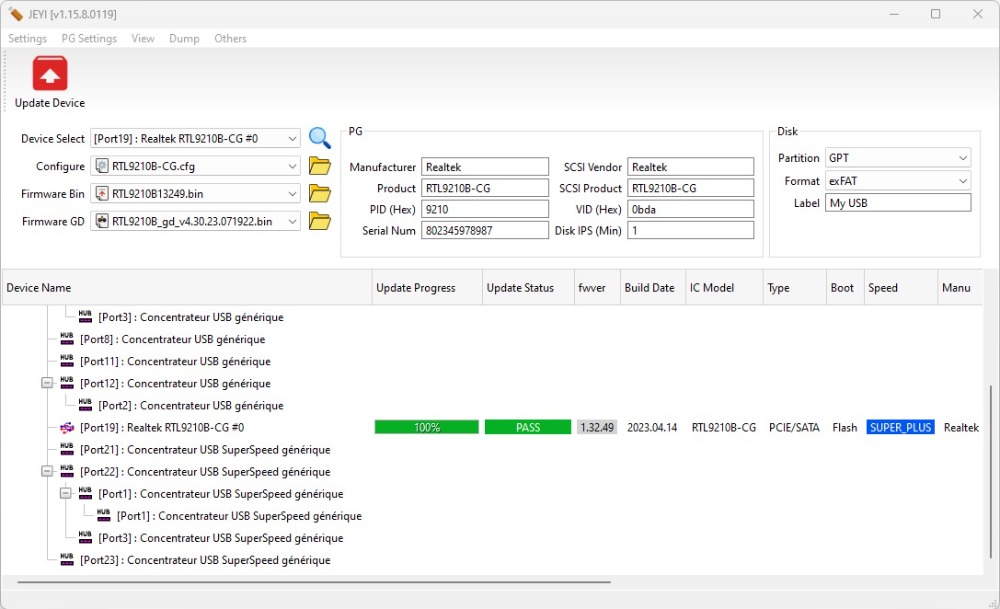

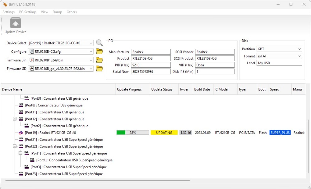

- wade7575
- Posts: 40
- Thanks: 6
I don't know why but I tried again and reflashed my Unionsine enclosure with v1.32.49 using HIKSEMI_MD202.cfg file and this it worked
