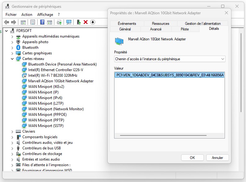

Okay, in Windows Control Panel, can you retrieve the Marvell ID?
Yes I can get all the IDs there.

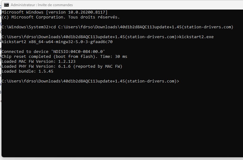

Try the command kickstart2.exe to get information about the board and see what's missing.
