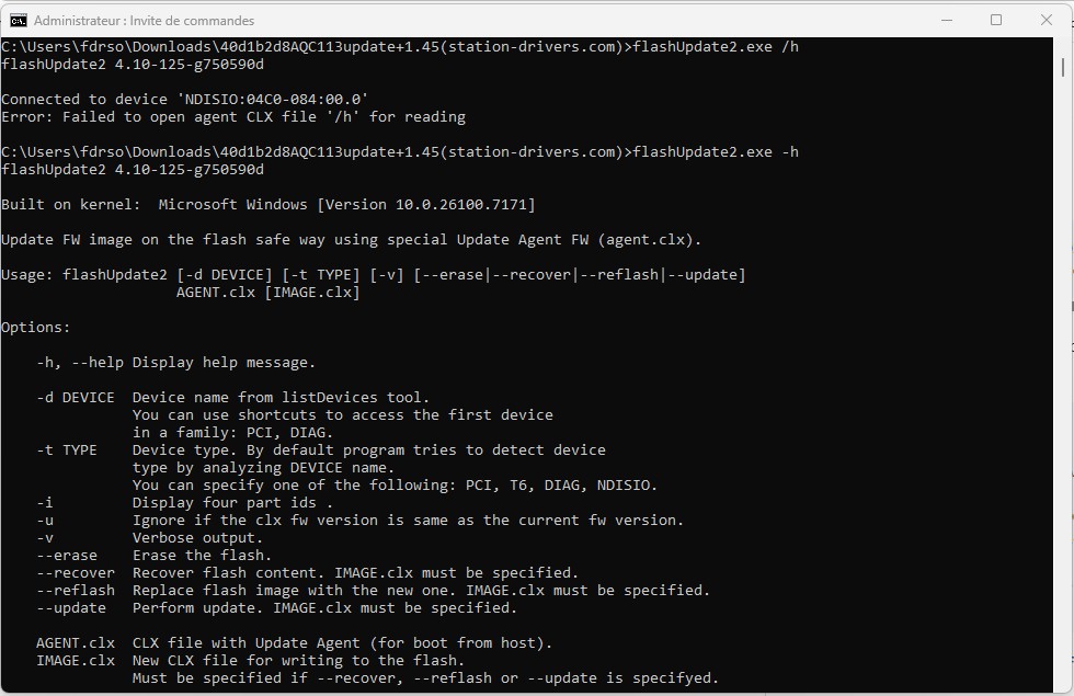

Same error with other firmware. Tried it by booting into Hiren Boot PE. Windows can recognise the card and HWID shows the correct 4 parts. But updater doesn’t see. Only sees 0000 0000 0000 0000. It cannot reset the card as well.

In CMD, launch the command flashUpdate2.exe -h; you will have options to force the update.
