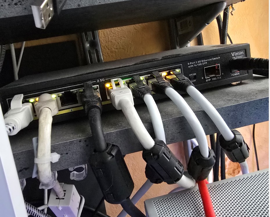

Since I am a maniac, I have been installing EFI filters on all my network cables for three years because they pass through electrical cables and other cables that can be parasitic.

Yeah i have ordered 5x7mm 5x9mm 5x13mm as a test run
and will be ordering a pile more to fit when i rewire the house and add optics
