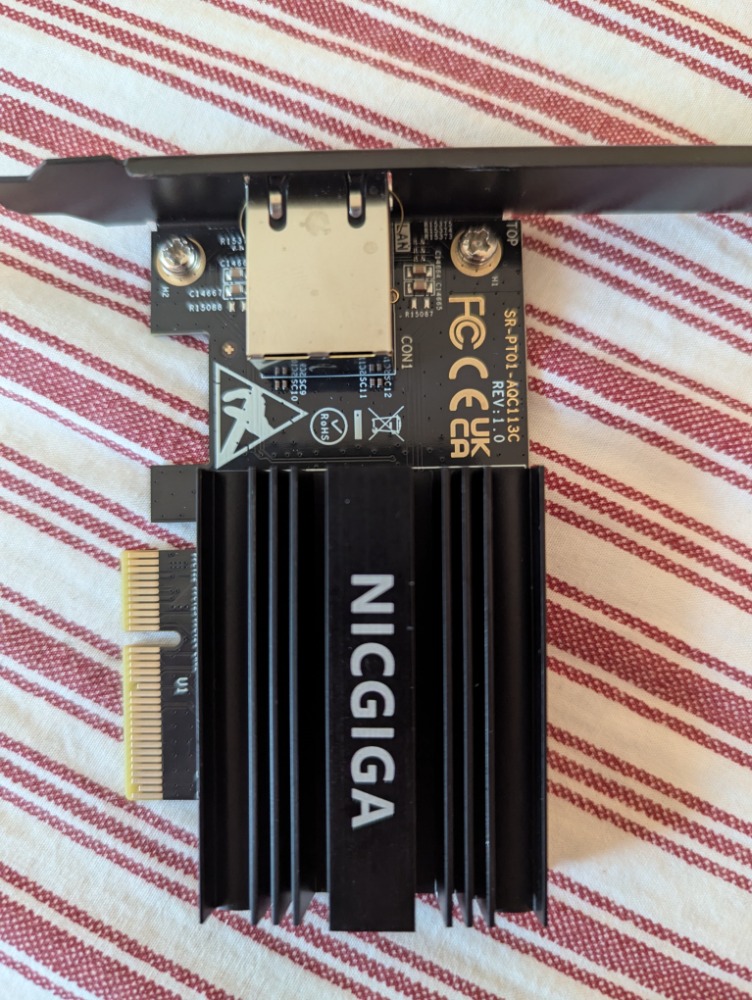

Hi @Shonk,
I just ordered a NICGIGA AQC113 NIC from Amazon , but it was actually a AQC113C. You mentioned your earlier AQC113C from NICGIGA didn't support WOL, but this one indeed does. I've tested WOL on both Windows and Linux and both work as expected. It looks different than the one you have so even though it's rev 1.0 as well it's a different board.
Looking at the NICGIGA website under PCIe NICs they only mention the AQC113C, so I guess they are phasing out the other model. I previously had a TP-Link TX401, which was a AQC113, but I had a lot of problems with connection stability and frequent disconnects, which quite a few others including yourself have mentioned in this thread. I ordered a new Cat 6a cable, but I haven't received it yet to replace the Cat 6a cable that came with the TP-Link NIC. Without changing anything else it's been more stable. The reason to try a new NIC first (in parallel actually) is because the reviews for the TP-Link mentioned lots of disconnections. I didn't see any mention of this from the NICGIGA reviews. So far it's been more stable and showing a little faster iperf3 results. I've only had it for the one evening, but it's enough already to say it's more stable.
One other final thing I want to add is this NICGIGA card already had firmware 1.5.42 on it so I didn't need to update it. It's IDs are not in the latest updatedata.xml so I don't know which firmware it flashes by default. It matches the Four Part IDs from the original NICGIGA ACQ113C Rev 1.0 you posted.
Not sure if there is any other information you'd want to know, but I wanted to share that this newer NICGIGA AQC113C appears to fix the disconnection issues. If it wasn't for wanting WOL support I'd just go with one of the Intel NICs.
FourPartIDs:0x1D6A:0x14C0:0x1D6A:0x0001
Les utilisateur(s) suivant ont remercié: Shonk
