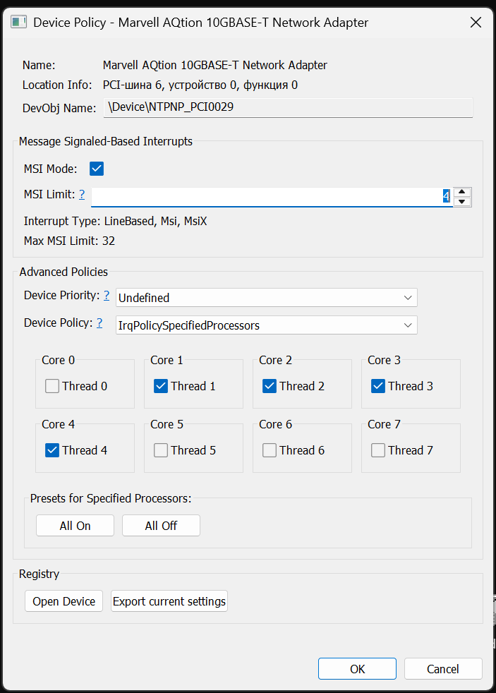

- Profy13
- Messages : 3
Hello! I need some advice. I set the card (PCI\VEN_1D6A&DEV_14C0&SUBSYS_E0001458; AQC113C) to Message Signaled-Based Interrupts. Everything works fine if the number of vectors is set to either 1 (traffic will be processed by only one CPU core) or any value from 17 to 32. However, values of 17-32 mean overhead, as my CPU only has 8 cores, and 17 or more vectors are excessive (E cores don't count, they're disabled).
However, I need to set MSI MAX LIMIT=4 vectors (all values from 1 to 8 are important), i.e., for four CPU cores, which will process traffic depending on the card's Receive Side Scaling settings.
The problem is that with any other values, my card doesn't initialize, i.e., It's in the task manager and working properly, but the "no internet" icon in the system tray is there.
I even tried flashing the Marvell_aqc113_1.5.42 firmware to fix the issue, but nothing happened. I'm asking for help. Do you know where I can contact support or something for help? Maybe they'll release a driver, etc. Thanks!

il y a 1 an 1 mois
Hi, I'm over 4, but it bugs.
