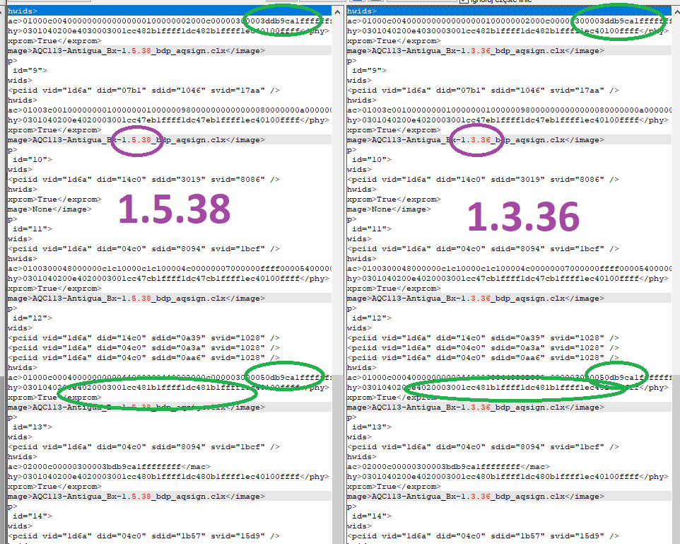

All firmwares contain the same PHY and MAC values:

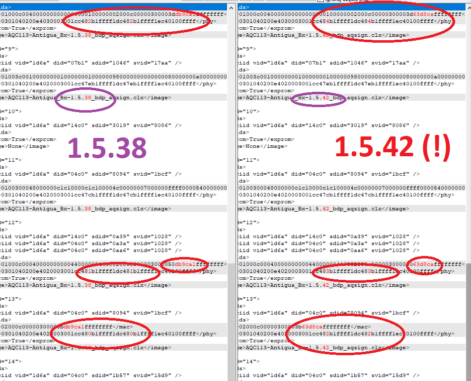

Only 1.5.42 version is different:
We can see that for almost all devices, MAC region has 63d8ca value instead of db9ca1 included in all previous firmwares.
In PHY we can see 2 changed bytes. All of them increase by 0x2 (0x86->0x88, 0x81->0x83, 0x85->0x87, 0x82->0x84, 0x80->0x82, 0x7F->0x81)
