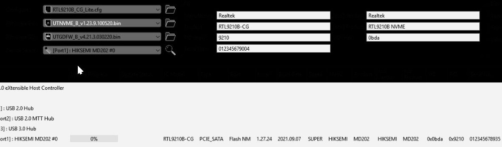

Got this multipurpose unit which includes a M.2 Realtek RTL9210B-CG chipset interface:
MPTool dump reports HIKSEMI_MD202 as the OEM.
I’d like to update the firmware and instead of risking a brick I thought I’d play it safe and post here after I noticed your post mentioning the HIKSEMI config file.
I’m including all the info I collected regarding this particular unit.
I’d highly appreciate guidance with putting together that config file correctly.
Cheers.

il y a 2 ans 2 moisOk, I ended up flashing using the following config file and fortunately everything worked flawlessly:Got this multipurpose unit which includes a M.2 Realtek RTL9210B-CG chipset interface:

VID = 0xbda
PID = 0x9210
MANUFACTURE = "HIKSEMI"
PRODUCT = "RTL9210B-CG"
SERIAL = "012345678936"
SCSI_PRODUCT = "MD202"
SCSI_VENDOR = "HIKSEMI"
DISK_HOTPLUG = 0x0
LED = 0x2
PINMUX1 = 0x0
PINMUX2 = 0x70
U2_MAXPWR = 0xfa
U3_MAXPWR = 0x70
ASPMDIS = 0x0
DISK_IPS_THRES = 0xa
SUSPEND_LED_OFF = 0x3
UART_DBG_PIN = 0x5
Boot Mode = false
IC Ver = 0xa0010002
Disconn_ForceUSB2 = 0x0
