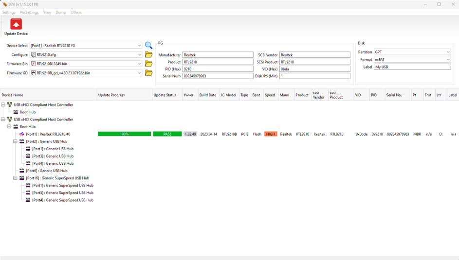

Tried flashing with 1.33.44, 1.33.7 1.32.68 but failed with no config file issue.
eventually worked with 1.32.49

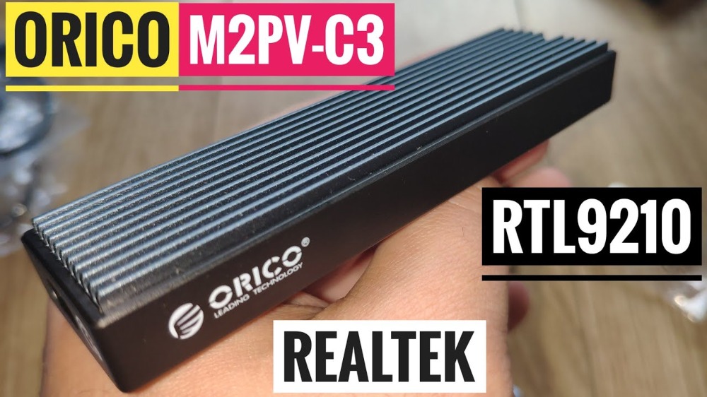

Orico shipped with 1.23.15 2020.11.16, unit was bought just last week.

@Wolfspam I own the same enclosure and I got it to flash with v1.33.44 and use configure file RTL9210_VB_CG_Orico_0_Mod.cfg I don't know why but I have had it had more then a few times like 5 or 6 times when updating the RTL9210 that it often fail then you try again with the same firmware that you just tried to flash the enclosure with and then it successfully flash's.
If you don't have this configure file I can email it to you.
