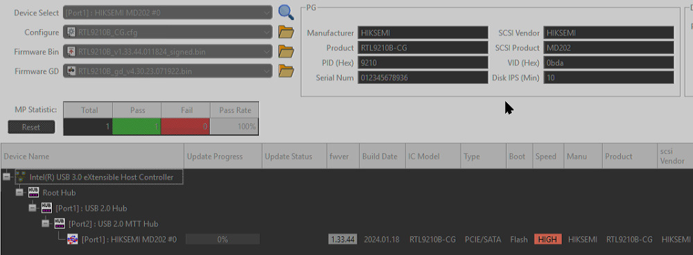

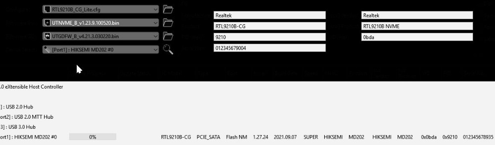

Got this multipurpose unit which includes a M.2 Realtek RTL9210B-CG chipset interface:
MPTool dump reports HIKSEMI_MD202 as the OEM.
I’d like to update the firmware and instead of risking a brick I thought I’d play it safe and post here after I noticed your post mentioning the HIKSEMI config file.
I’m including all the info I collected regarding this particular unit.
I’d highly appreciate guidance with putting together that config file correctly.
Cheers.
Device : [Port1] : HIKSEMI MD202 #0
U2PHY : 02 f4 9b e0 e1
U3PHY : 02 d4 09 00 d5 00 80
PID : 0x9210
MANUFACTURE : "HIKSEMI"
PRODUCT : "MD202"
SERIAL : "012345678935"
SCSI_PRODUCT : "MD202"
SCSI_VENDOR : "HIKSEMI"
DISK_HOTPLUG : 0x00
LED : 0x02
PINMUX1 : 0x00000000
PINMUX2 : 0x00000070
U2_MAXPWR : 0xfa
U3_MAXPWR : 0x70
ASPMDIS : 0x00
DISK_IPS_THRES : 0x0a
CUSTOMIZED_LED : n/a
SUSPEND_LED_OFF : 0x03
EFUSE :
Boot Mode : Flash NM
FW Ver : 1.27.24
FW Build Date : 2021.09.07
IC Ver : 0xa0010002
IC Pkg Type : PCIE_SATA
Disconn_ForceUSB2 : 0x00

2 years 2 months agoOk, I ended up flashing using the following config file and fortunately everything worked flawlessly:Got this multipurpose unit which includes a M.2 Realtek RTL9210B-CG chipset interface:
Cheers.
PID : 0x9210
PRODUCT : "MD202"
DISK_HOTPLUG : 0x00
LED : 0x02
U2_MAXPWR : 0xfa
U3_MAXPWR : 0x70
ASPMDIS : 0x00
EFUSE :
FW Ver : 1.27.24
IC Ver : 0xa0010002
VID = 0xbda
PID = 0x9210
MANUFACTURE = "HIKSEMI"
PRODUCT = "RTL9210B-CG"
SERIAL = "012345678936"
SCSI_PRODUCT = "MD202"
SCSI_VENDOR = "HIKSEMI"
DISK_HOTPLUG = 0x0
LED = 0x2
PINMUX1 = 0x0
PINMUX2 = 0x70
U2_MAXPWR = 0xfa
U3_MAXPWR = 0x70
ASPMDIS = 0x0
DISK_IPS_THRES = 0xa
SUSPEND_LED_OFF = 0x3
UART_DBG_PIN = 0x5
Boot Mode = false
IC Ver = 0xa0010002
Disconn_ForceUSB2 = 0x0
