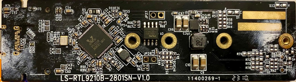

I realised the board was just held in with clips and easy to take out/put back in, so here's a picture of the side of the board with the Realtek chip too for anyone interested:
A few of the packages here had the firmware GD file for RTL9220 chips, but I've not been able to find any actual firmware bin files available for it.

Maybe someone will be interested – Qoltec NV2270 Model: 52270M.2 STAT/NVMe enclosure
*NOTE: This white paste all around PCB isn’t just this exact unit issue, but local distributor confirmed that everything what they have on their warehouse looks like this.
Anyway, the most interesting is firmware:
FW Ver : 9.29.33
FW Build Date : 2022.04.21
All firmware available here are starting from 1.xx.xx, so I’m wondering how different is this 9.xx.xx one? Could be safely updated with 1.33.44.011824?
