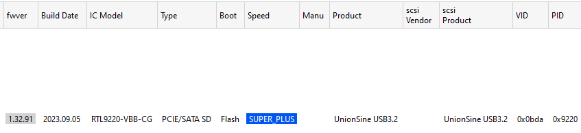

I recently got a UnionSine NVME Enclosure, it's supposed to support USB 3.2 Gen 2x2 20Gbps (though I have no way of verifying this, as my PC supports a maximum of 10Gbps).

Device : [Port8] : UnionSine USB3.2 #0
U2PHY : n/a
U3PHY : n/a
PID : 0x9220
MANUFACTURE : " "
PRODUCT : "UnionSine USB3.2"
SERIAL : "012345679554"
SCSI_PRODUCT : "UnionSine USB3.2"
SCSI_VENDOR : " "
USB_SELF_PWR : n/a
DISK_HOTPLUG : n/a
LED : 0x03
PINMUX1 : n/a
PINMUX2 : n/a
U2_MAXPWR : n/a
U3_MAXPWR : n/a
ASPMDIS : n/a
DISK_IPS_THRES : n/a
UART_DBG_PIN : 0x64
HW_LED_CFG : 0x00000000
PERIPH_API : n/a
RAID_CFG : n/a
FW Ver : 1.32.91
FW Build Date : 2023.09.05
IC Pkg Type : PCIE/SATA SD

PC Config: AMD Ryzen 5800X3D, B550 AORUS ELITE AX V2 (rev. 1.1), 64GB RAM, Samsung 980 Pro 2TB, Samsung 980 1TB, HGST 4TB x3.

Which Unionsine enclosure do you have,they sell 2 that look almost the same and the other is called Hiksemi and people get them mixed up,I own both that way I have 2 different looking enclosure's because I need a lot of portable storage space.
