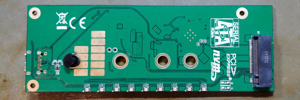

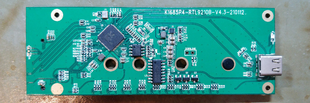

Hello
I have a K1685P4 RTL9210B Enclosure. It came with Firmware 1.24.xx and had a lot of trouble with working under Linux.
Thus, I tried updating the Firmware to 1.27.xx. But the update failed, and the Enclosure isn't detected properly anymore since via USB.
The WCH Controller for the RGB lights is still recognized, but the RTL Controller not. I'm also not sure how it mixes the WCH Controller and RTL Controller. To my understanding, the WCH Controller is connected via USB2.0 to the RTL Controller and this one bypasses it over USB3.2 to the Host.
This theory would also result that the RTL Controller is still working. But I don't get anything RTL related detected over USB.
This is the dmesg result:
Any idea what I could try?
I have already tried the following things:
- Connect VSS and CS on the SPI Flash to reprogram it over Update utility (no RTL chip detected over USB)
- Erased the SPI Flash with a BIOS Programmer
- Entered Download Mode with connecting the Download Pins. This puts the WCH Controller into Downloading mode.
- Holding the WCH Controller in Reset.
[ 8645.088472] usb 2-1: new full-speed USB device number 15 using xhci_hcd
[ 8645.248430] usb 2-1: New USB device found, idVendor=1a96, idProduct=e010, bcdDevice=13.00
[ 8645.248435] usb 2-1: New USB device strings: Mfr=1, Product=2, SerialNumber=3
[ 8645.248436] usb 2-1: Product: HID To Serial
[ 8645.248437] usb 2-1: Manufacturer: WCH.CN \x13
[ 8645.248438] usb 2-1: SerialNumber: 12345678
[ 8645.281767] hid-generic 0003:1A96:E010.0005: hiddev96,hidraw1: USB HID v1.00 Device [WCH.CN \x13 HID To Serial] on usb-0000:05:00.4-1/input0
