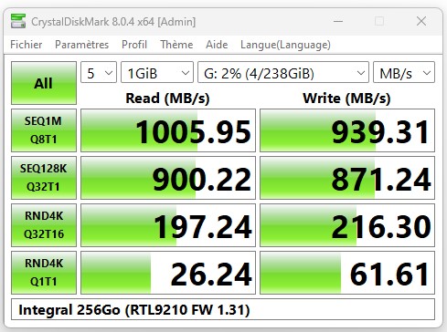

I'm posting the speed test numbers I got from Crystalmark,and when I did transfer of large video files I was getting 700mb's from what Windows 10 was saying.

You can easily publish the image I did for mine case containing the latest firmare 1.31
