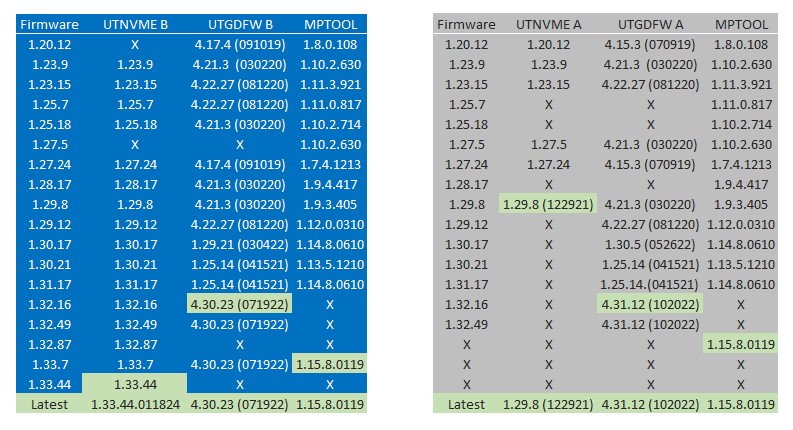

Have you tried selecting the files with by clicking on the folders that are circled in red in the picture that you included.
I have had to try installing older firmware a few times with the RTL9210 controllers before,for whatever reason they can be a real pain when they want to be and then after installing an older firmware a lot of the time the firmware that wouldn't load the files or even let me select them now would after installing older firmware.
station-drivers.com/index.php/en/compone...1.120722/lang,en-gb/
station-drivers.com/index.php/en/compone...7.191023/lang,en-gb/
Also you can try contacting this seller on aliexpress they are the JEYI company and you can try asking them for the proper firmware for your device as well.
www.aliexpress.com/item/1005006754982743...n.123.7bb71802ePiA1V

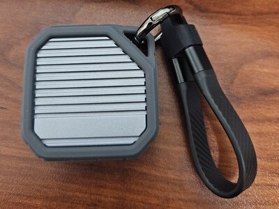

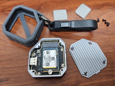

Hi guys, I just bought a new NVMe enclosure from Aliexpress. It's the tiny 2230 ones. The same box is sold under several different brand names. Mine is Colorii and I believe it's the original manufacturer. It has an RTL9210 controller. The firmware is extremely up to date, 1.33.98.

Hi can you make a backup of the firmware?
- AOnurY
- User
1 year 9 months ago
Of course, but I guess Mptool Lite can't do this job. I couldn't find the full version. If you help me, I can fix it. By the way, I have a question. The controller of this device is a simply 9210, can I use its firmware for 9210b-cg?
