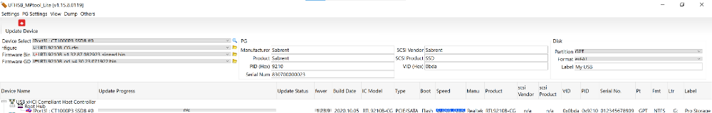

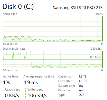

Hello all, I have a problem with my Inland Premium Enclosure (9120B)

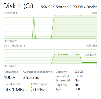

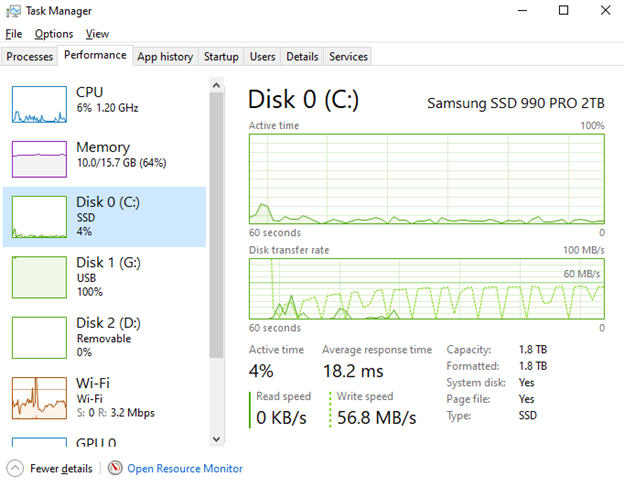

PROBLEM: Starts at 300 mb/s, then slows to 40 mb/s after ~10-30 gigabytes when COPYING FROM the enclosure. ***The limiting factor is the enclosure itself, see the attached photos
SYSTEM: Transfer FROM crucial P3 TO samsung 990 pro. Firmware updater registers super plus speed. Single large iso transfer. No Other peripherals but integrated laptop peripheral connected.
TROUBLESHOOTING: I have tried nearly every firmware update on this page using the stock 9120b configuration that comes with most of the files. I have also tried the SSK and orico configurations as well.
From the photos, it is definitely the enclosure that is the problem, not the computer itself. The connection is fine and it is registering at least 300 mb/s of sustained transfer before it slows down. This occurs on other computers, as well as while transferring to a non-shingled hdd that has 250 mb/s sustained write. I for the life of me cannot figure out why the enclosure is slowing down like this.
Nothing is excessively hot. I unfortunately do not have the original configuration for the enclosure. Any help would be amazing.
The enclosure came with 1.29 BTW, I have tried flashing everything from 1.17 to 1.32 on the enclosure.

Hi,
The problem can be multiple such as the supplied USB cable which is of poor quality, the PC's USB drivers to be updated if necessary.
put your PC on performance instead of saving because this also affects the performance of the USB ports

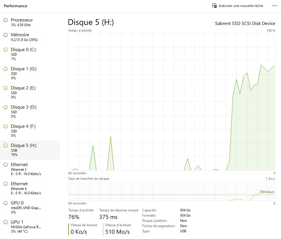

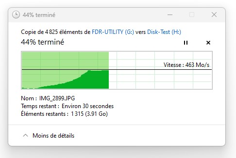

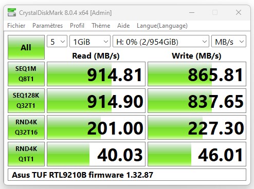

Here but performance with AN RTL9210 on my Asus TUF

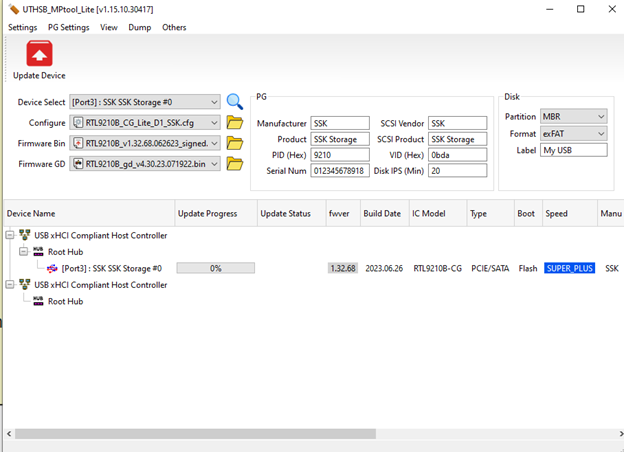

Hi there and thank you for the reply. I just went to microcenter to exchange the enclosure for a new one, and I'm finding the same exact issue on a non-firmware updated enclosure.
I am using a cable analogous to this one.
It is a flexible PCB cable that should have the least amount of resistance.
If I use teracopy, which limits the speed at which the drive can transfer to ~240 mb/s, it doesn't have the slowdown issue. If I let windows go full speed on the transfer, I end up with the same problem.

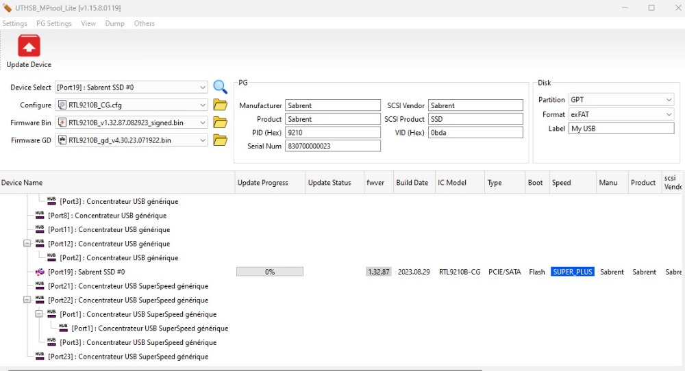

The attached image is the stock firmware and settings from the update tool. I also have now saved the configuration.
