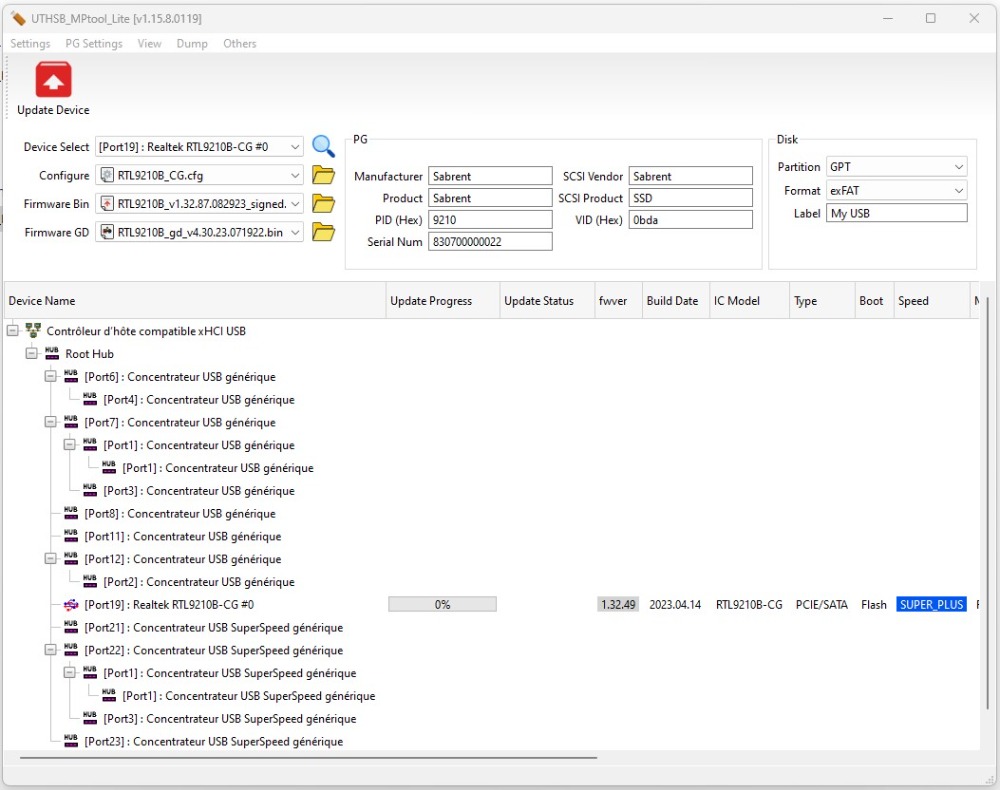

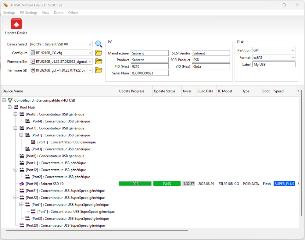

Hi Have you checked the model and revision, otherwise you can revert to the old firmware see the method below
New : Realtek RTL9210B NVMe/USB 3.1 Controller firmware Version 1.32.87
Old
New

An Orico branded (RTL9210) NVMe external enclosure purchased from Amazon came from the factory with firmware version 1.24.3. Connected via USB C or USB 3.0 port, the firmware update did not work. Then tried connected to a USB 2.0 port, and the firmware update did actually function. Firmware now on version 1.32.87. Thanks.
