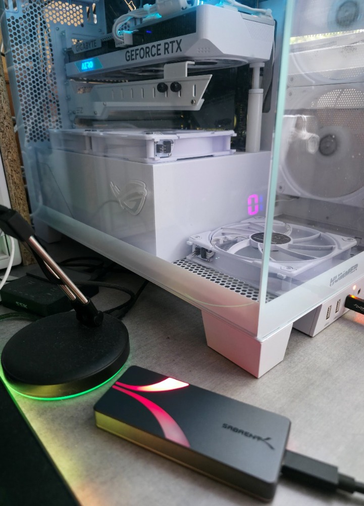

Thank you, I managed to make a part work and by changing the led line of the CFG file now the part flashes but not on the whole part, too bad
