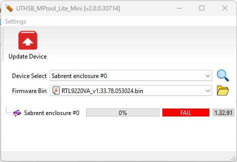

1 year 3 weeks ago - 1 year 3 weeks agoI will try the update directly with the MPTool mini utility because it does not require a configuration file and I think it does not overwrite the configuration of the LED lights, I will confirm this afternoon upon receipt of a new Sabret RTL9220 RGB box
I confirm, it does not erase the configuration of the original firmware but it fails on the update, too bad

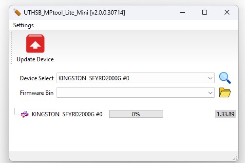

Hi guys,
where to download MPTool mini utility? I tried version mini which shipped with RTL9210 but it did not recognise enclosure
