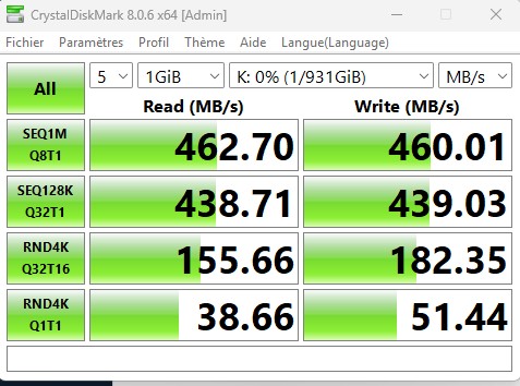

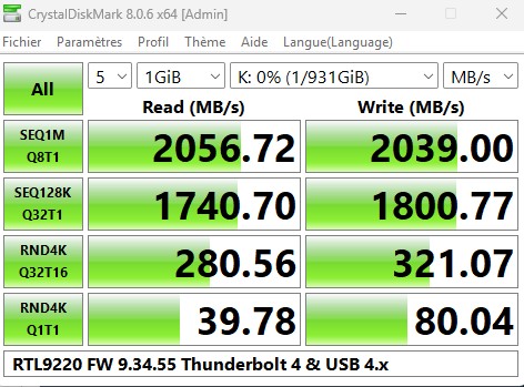

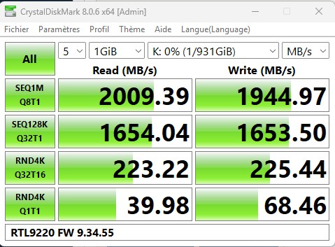

Finally, a firmware that solves my throughput issues on my RTL9220 enclosures, which have been mediocre from the start.
This is the first time I've seen a firmware that boosts the performance of my external drives.
USB 3.2 X2
USB4.x & Thunderbolt 4
Please feel free to leave a comment if you notice any improvement.

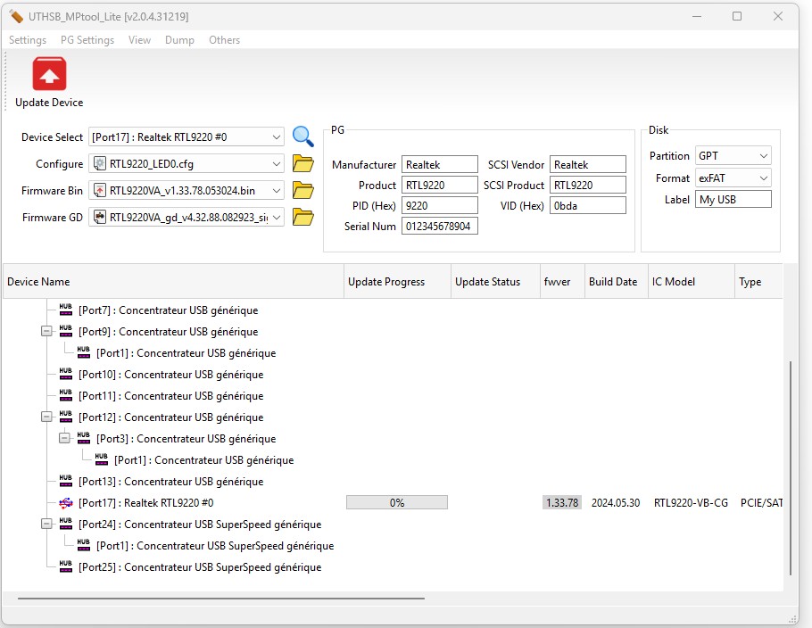

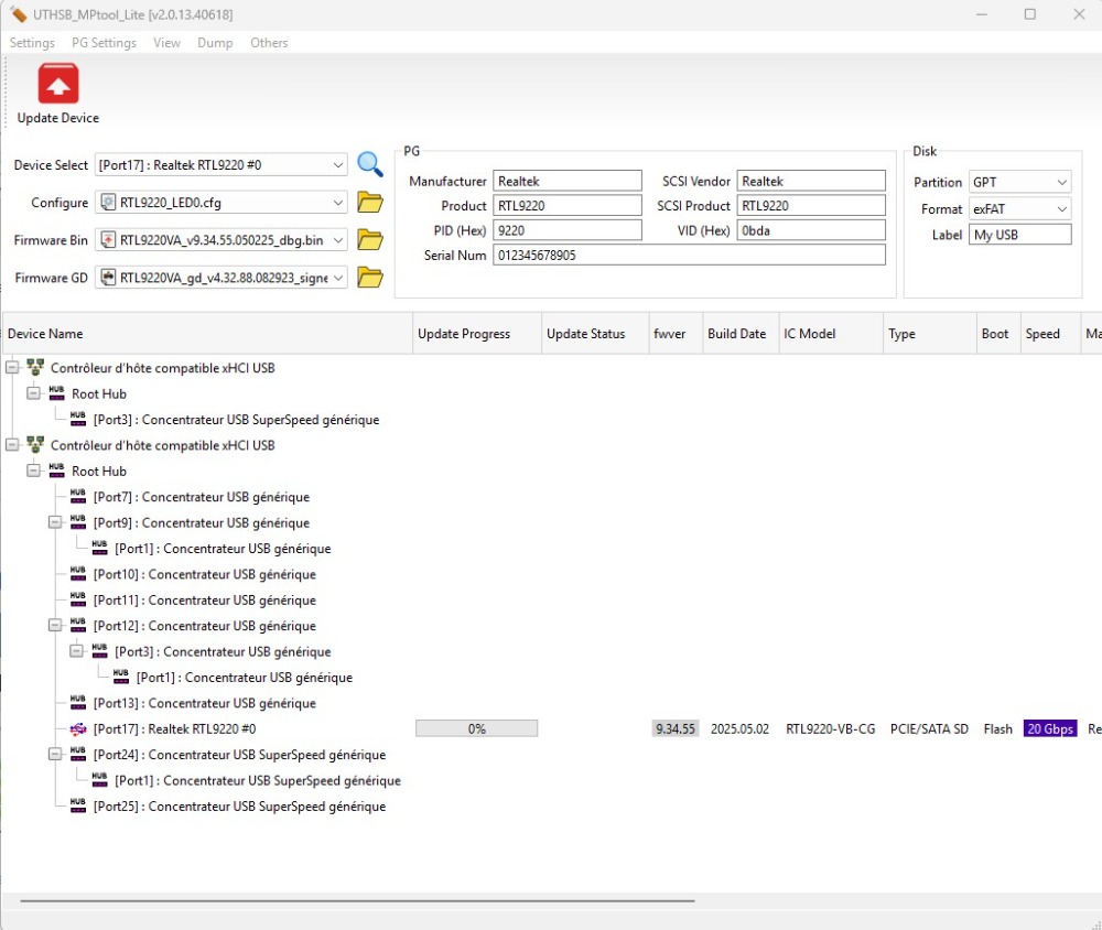

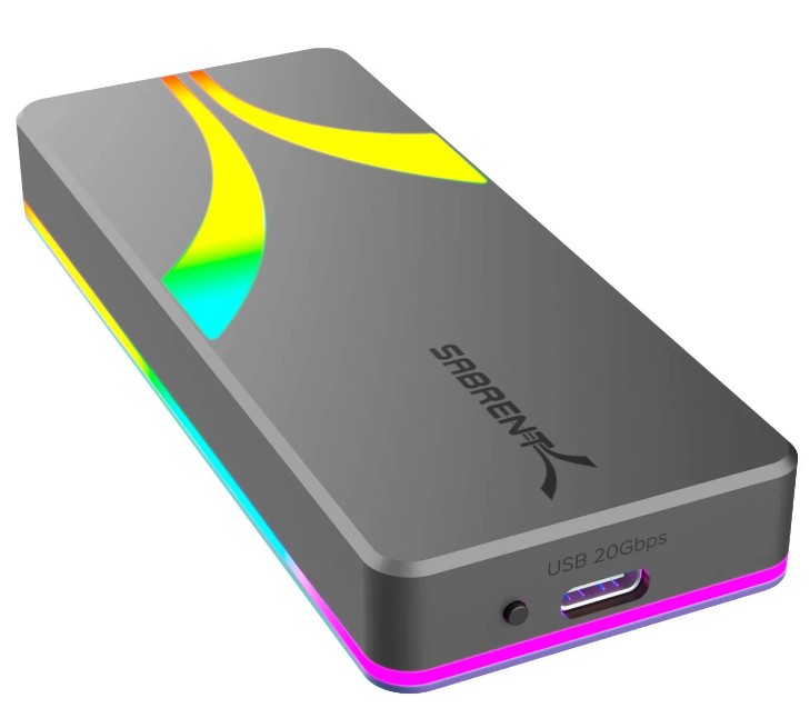

1 year 3 months agoHi everyone, I'm looking for a way to recover the *.bin firmware that allows the box to illuminate the LEDs because otherwise after a firmware update, I automatically lose the LED lighting part of the box.
- Posts: 45
Noway to recover Firmware with MPtool you can try to Dump but maybe it´s a special Frimware i don´t now.
- Dump -> Show Device Info -> Save
- Delete first 3 lines and all the lines after the empty line towards the end
- Substitute all the ":" characters with "=" characters
- Save as .cfg and use it in UTHSB_MPtool
Last edit: 1 year 3 months ago by sdefrwggerg.
Thank you very much, I tried but it erases the CFG file and is there a need for a *.bin file for the LED strips?
