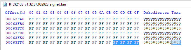

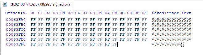

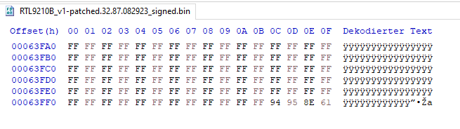

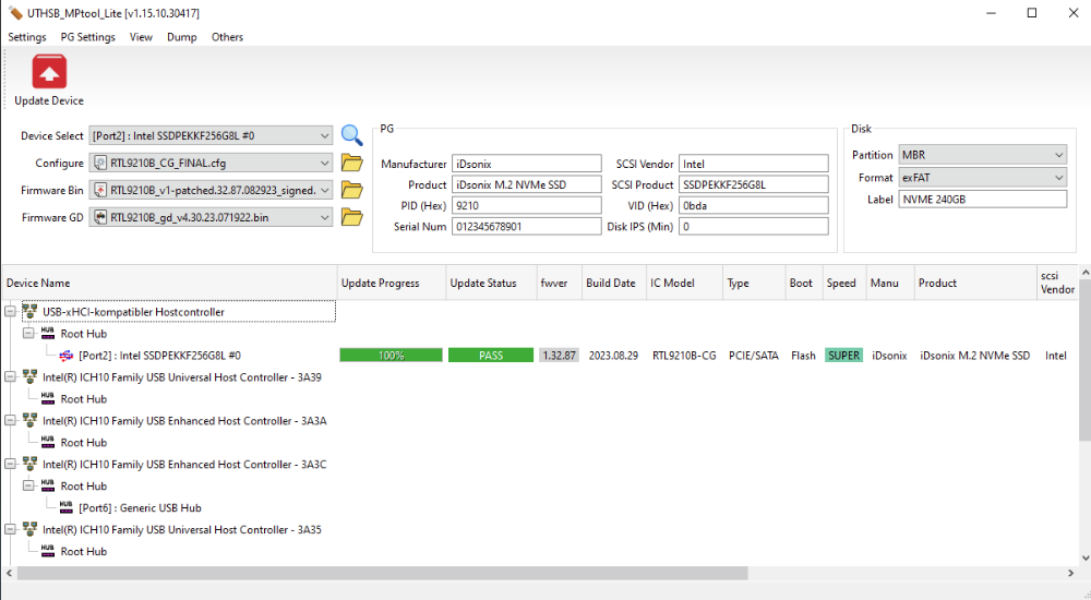

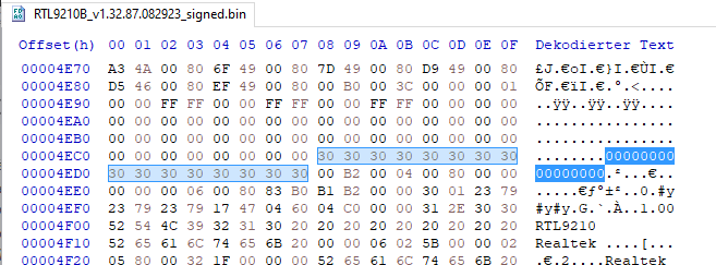

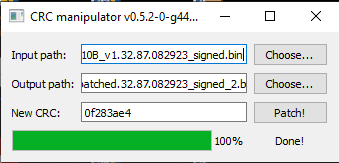

2 years 10 months ago - 2 years 10 months agoThanks for that - very helpfull - That makes me think about an solution to get it work with newer/latest MPTool-Versions.2. However, config serial will not appear in WMIC - if you run wmic diskdrive get name,size,model,SerialNumber command in Windows cmd, it will still show "0000000000000000" as drive serial. It is device UUID which is not possible to be changed in firmware config, but there is a way around - you can hex edit the firmware itself. UTHSB MPTool Lite ver. 1.14.8.0610 or below is required - newer versions have CRC32 check for firmware file and if you try to flash modified file it will semi-brick your device (does not work but can be reflashed without shorting pins). Save somewhere original .bin as backup, open your firmware.bin (not the GD one, you don't need to touch that at all) file in hex editor and find those 16 zeros in it - for example RTL9210B 1.32.49 firmware file has them at address 00004ea0. Replace them with anything you want (just in case better keep it the same length 16 symbols so you won't break anything else in firmware). Save, choose edited firmware file in MPTool, flash. That's it - device UUID changed and WMIC will show your new UUID if you run the command. Dump from MPTool will still show UUID as "n/a" though, that is normal.sdsdsd
Here is the way.. All in all its about faking CRC32...
Find the original CRC32 - Use CRC32-File mode anbd drop file there.
emn178.github.io/online-tools/crc32_checksum.html
For RTL9210B_v1.32.87.082923_signed.bin its 0f283ae4 - wee need it for the next step.
Modifiy your file as peer user exodus - Use Hex-Editor (HxD is easy to use) search (STRG-F) for 0000000000000000 and it jumps to those 16 digits.
Important - Overwrite those 16 digits - for example 1234567891234567. Then jump to the end of file and delete the last 4x FF - Yes - this will shorten the file! Normal not good but OK here.
Now use tool CRC-manipulator
github.com/rr-/CRC-manipulator/releases -> crcmanip-0.5.2-bin.zip -> crcmanip-gui.exe
Load your modified file (with new serial and with deleted 4x FF at the end) and use the former noted original CRC32 (for file RTL9210B_v1.32.87.082923_signed.bin its 0f283ae4) and patch it.
This will add back again 4 digits at the end with our fake CRC32 (0f283ae4).
This is the reason why I deleted those 4x FF at the end. FF means "nothing/emty/no Data" - I thing its better to keep the original filessize after patching...
You check this new patched file again with emn178.github.io/online-tools/crc32_checksum.html - It shows the same original CRC32 as file without Serial adjustments...
Maybe to much hassle for the benefit - But I like to dig deep and get things working!
