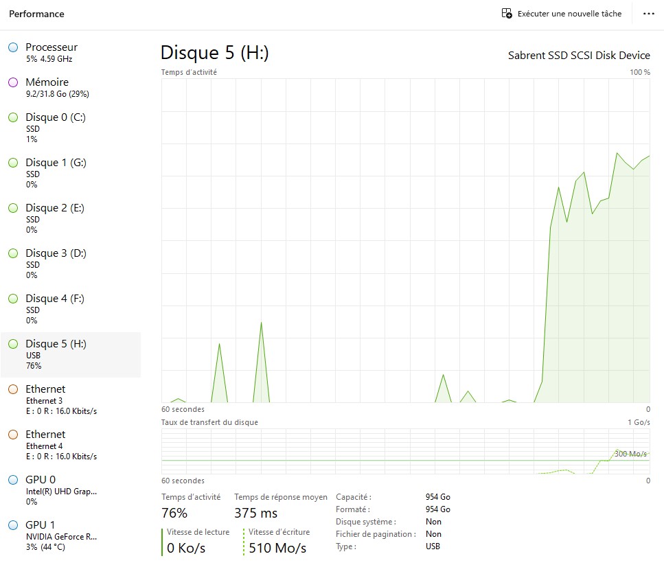

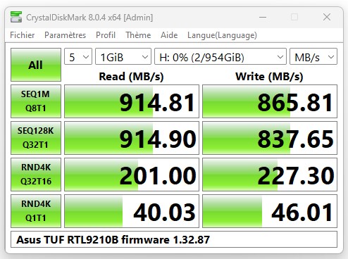

Hi,
The problem can be multiple such as the supplied USB cable which is of poor quality, the PC's USB drivers to be updated if necessary.
put your PC on performance instead of saving because this also affects the performance of the USB ports
Here but performance with AN RTL9210 on my Asus TUF

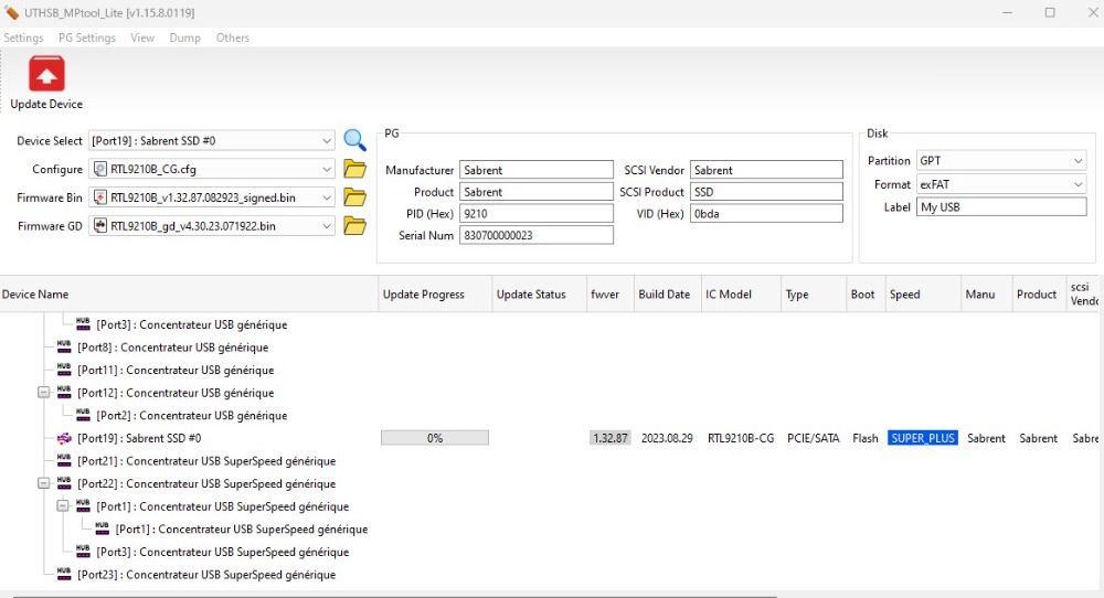

Hi there and thank you for the reply. I just went to microcenter to exchange the enclosure for a new one, and I'm finding the same exact issue on a non-firmware updated enclosure.
I am using a cable analogous to this one.
It is a flexible PCB cable that should have the least amount of resistance.
If I use teracopy, which limits the speed at which the drive can transfer to ~240 mb/s, it doesn't have the slowdown issue. If I let windows go full speed on the transfer, I end up with the same problem.
The attached image is the stock firmware and settings from the update tool. I also have now saved the configuration.

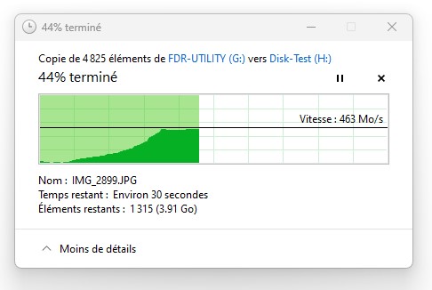

- Fishwithadeagle
- Posts: 6
2 years 11 months ago
I noticed that you are using multiple files present. What happens if you try and transfer a single 40+ gb file on your drive? Does it slow down?
