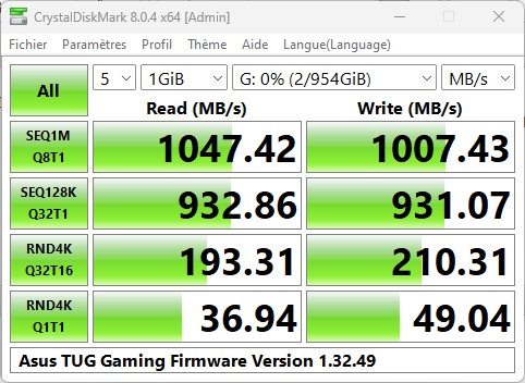

RTL9210B_v1.32.49.041423 works fine here i used a cfg i made myself from a dump of the factory device information that was then customized
[img
Last edit: 3 years 6 months ago by Shonk.

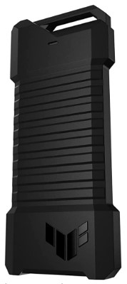

Version 1.32.16 cause problems with the box but no problem with the latest firmware and the Asus TUF 1.32.49 box even with the default Realtek RTL9210B config
