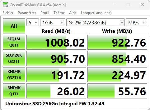

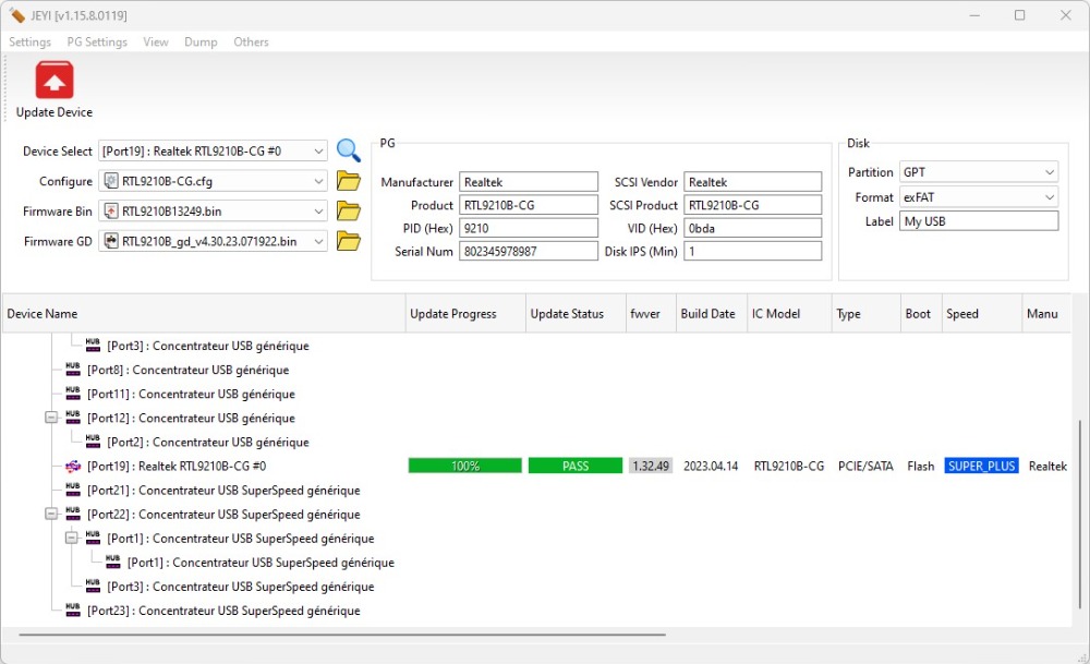

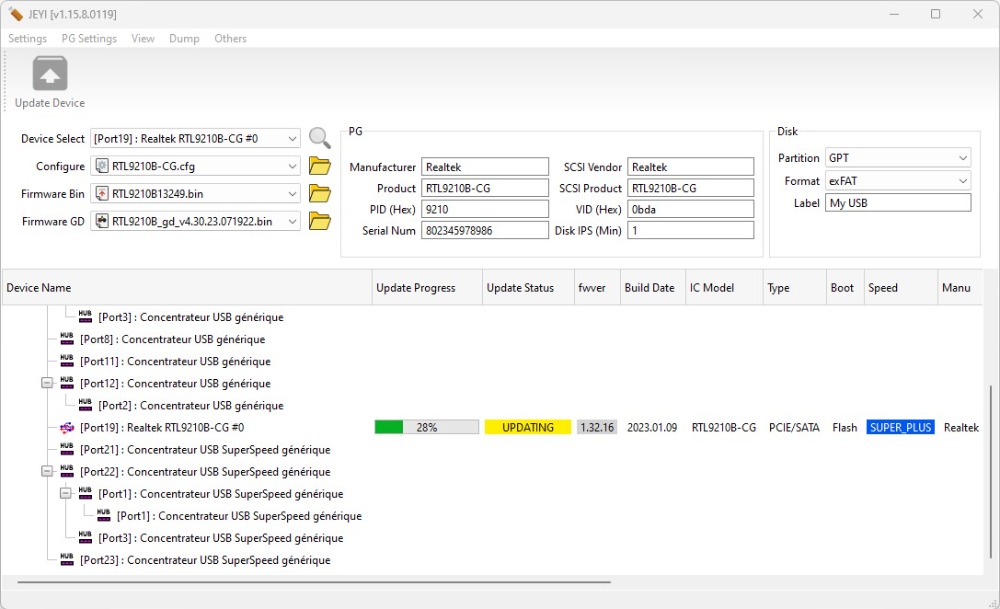

I don't know why but I tried again and reflashed my Unionsine enclosure with v1.32.49 using HIKSEMI_MD202.cfg file and this it worked
