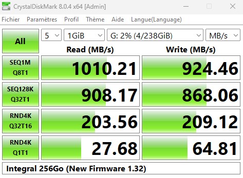

Thank you machi007
on my side no problem everything works fine
www.station-drivers.com/index.php/en-us/...6.010923/lang,en-us/
