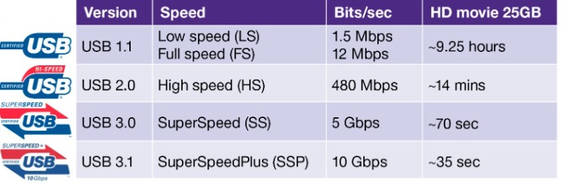

Hi all,
I allow myself to add that certain USB-C cable provided does not sound efficient to be able to have 10Gbs so try with another USB 3.2 cable (10Gbs) and also check that you are on a USB 3.2 port

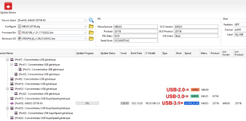

il y a 3 ans 8 moisHi sdefrwggerg,@xz Thank you maybe you can ask Support why an old GD firmware was used
can you please share your Config File RTL9210_VB_CG_Orico_0m2.cfg ?
I can't find it anywhere.
I have Orico SSD enclosure and I want to upgrade to newest FW
