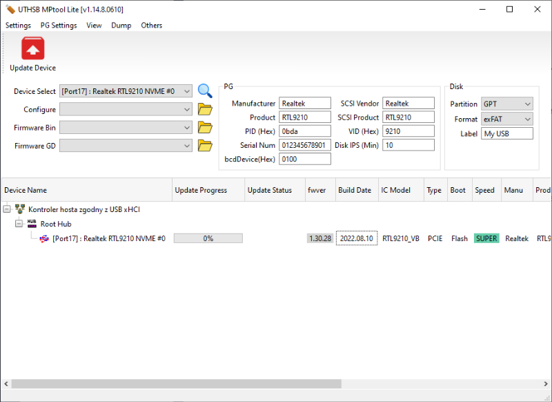

Hi, I checked the firmware on my case and it is newer than the one you recently posted.
Fw version: 1.30.28 and build date: 2022.08.10.
I would like to make a backup and post it here, but I don't know how. Could someone explain to me what software is needed to make a backup? The mptool lite can only update the firmware, if I remember correctly.
il y a 3 ans 9 mois
Hello Crills ,
Yes shame but if the MPTool does not allow it, if someone else has the solution, I take
