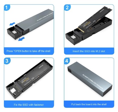

I thought I would post this enclosure that I purchased from aliexpress and do a small review of it,I purchased this enclosure because it all aluminum and has an RTL9210B controller and the price was only 17.00 dollars Canadian funds with shipping included which is about half the price of an Orico enclosure that is aluminum.
This enclosure has a slide in bottom that go into grooves into the side of enclosure and then a single screw stops the bottom from sliding off,this enclosure also comes with a metal standoff to secure the end of the ssd instead of the rubber plug's that some enclosures come with,my Unionsine enclosure came with a usb C to C and a usb A to C cable as well.
The only one thing I don't like about this enclosure is the screw driver that comes with it it is to 1 or 2 size's to small for the screws that are included with the enclosure so if you purchase one of these enclosures be sure to use a bigger star screw driver.
