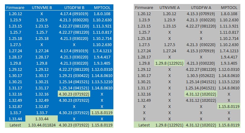

Have you tried selecting the files with by clicking on the folders that are circled in red in the picture that you included.
I have had to try installing older firmware a few times with the RTL9210 controllers before,for whatever reason they can be a real pain when they want to be and then after installing an older firmware a lot of the time the firmware that wouldn't load the files or even let me select them now would after installing older firmware.
station-drivers.com/index.php/en/compone...1.120722/lang,en-gb/
station-drivers.com/index.php/en/compone...7.191023/lang,en-gb/
Also you can try contacting this seller on aliexpress they are the JEYI company and you can try asking them for the proper firmware for your device as well.

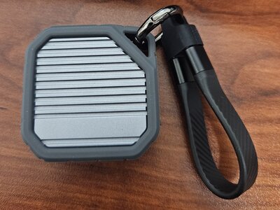

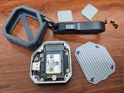

Hi guys, I just bought a new NVMe enclosure from Aliexpress. It's the tiny 2230 ones. The same box is sold under several different brand names. Mine is Colorii and I believe it's the original manufacturer. It has an RTL9210 controller. The firmware is extremely up to date, 1.33.98.

Hi can you make a backup of the firmware?
- AOnurY
- Membre
il y a 2 ans 4 jours
Of course, but I guess Mptool Lite can't do this job. I couldn't find the full version. If you help me, I can fix it. By the way, I have a question. The controller of this device is a simply 9210, can I use its firmware for 9210b-cg?
