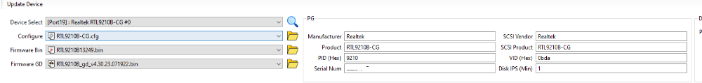

@cyberops
i used the default config file that was in the app (used all the default, ill post a printscreen soon). where can i find the correct config or how can i tell that im using the correct one?

thank you for explanation :) and regarding firmware update? i used this settings:

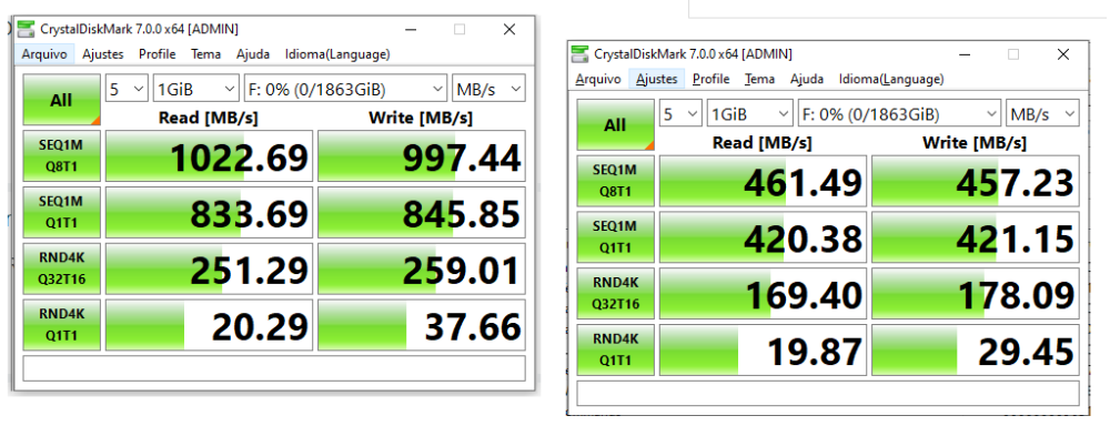

it seems that the cable i was using was not the best one. the left image is using usb-c provided cable, right image is using usb in a usb 3.0.
I still have problems (i think it powers down) with the device while working. does someone have any idea why? this happens in a old barebone with usb 2.0. is this because of not enough power?
