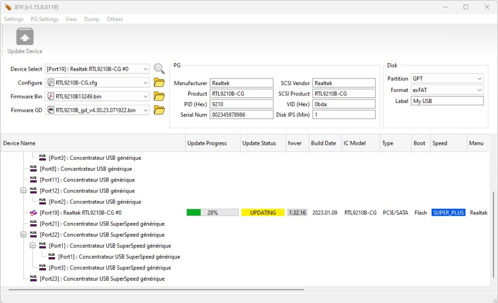

il y a 3 ans 6 mois - il y a 3 ans 6 moisEverything works fine only the activity led stays on constantly but I will modify the Realtek configuration file for this
Config file

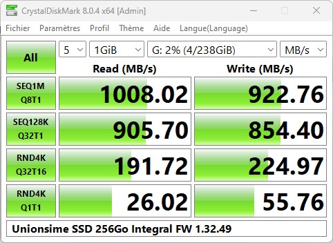

by putting the original configuration file, the performances are identical, I find the best

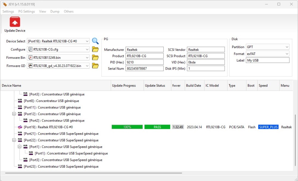

I don't know why but I tried again and reflashed my Unionsine enclosure with v1.32.49 using HIKSEMI_MD202.cfg file and this it worked
il y a 3 ans 6 mois
- Messages : 45
il y a 3 ans 6 mois
Before flashing the firmware, you must first know which of VA, VB, and CG your box is and the USB has been correctly identified!
Some motherboards will recognize CG as VB, and the disk will be lost after flashing.
Please try to use USB3.0 A port when flashing, avoid using C port and USB Gen2 mode.
