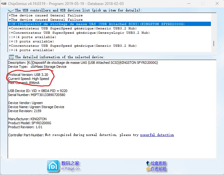

Hi, try checking directly via the chipgenius utility what speed your case is running at to be sure it's 10Gb.
Otherwise, for the firmware, it depends if you see a change on the LED because the configuration allows the LED of the case name to work...

I downloaded all the configurations from the github of bensuperpc and started to try them and one ADATA SE800 configuration made the led work. So i guess it works now? Then I changed the name and some other things with realtek configuration. Also, I checked the speed from chipgenius and its the same as yours so I think the drive is not getting enough power from the usb port. I will have to use the type c port either way :P
